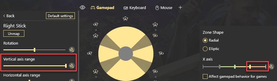

                            I suppose I wasn't clear enough. If you want to be able to reach maximum deflection of a virtual stick while using recoil compensation combo, you can use [High zone] on another [Shift] to nullify it. To do that:
                            In advanced settings of a stick set [Vertical axis range] to maximum and set the size of a [High zone] where recoil compensation will stop working:

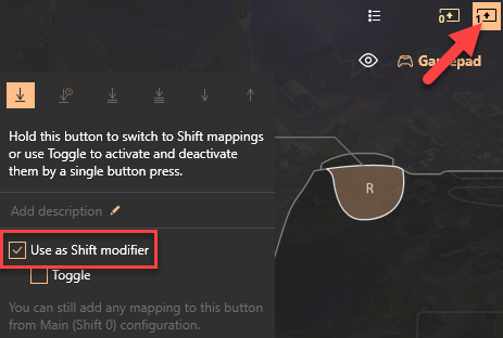

                            Set your "shot" button as a shift modifier:

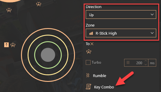

                            In advanced settings of a right stick on "shot" shift, add a [High Zone] mapping for [Up] direction with the combo of "Right stick Up" with the same, but positive value of recoil compensation (if there is a -20 value in recoil compensation combo, set value of this combo to 20):

                            Take note, that this will not work properly if recoil compensation changes with time.
