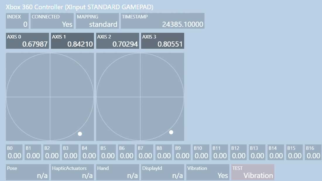

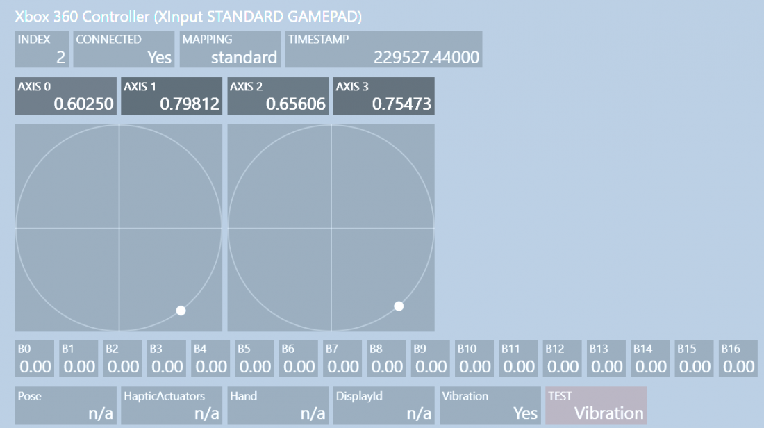

              I noticed something strange when I used the tester. My thumbsticks can't reach as far when remapping is set to ON. I've taken snapshots to show you the maximum thumbstick distance with and without the remap. I have snapshots for both my Elite 2 controller and my regular wireless controller.

                The stick range value is 32000 and we emulate this range precisely, so such behavior at the max stick deflection (along the radius) is normal when remap is ON.
                But it has аny impact in the game at all. We will try to reproduce the reported issue today with installed GTA V and share details.
