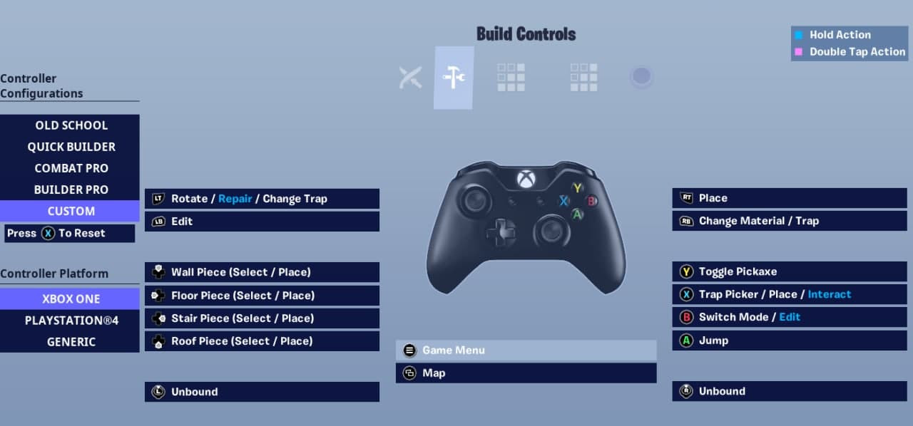

                      I am in chapter 2 season 2 now of fortnite, and i was wondering how you apply builder pro to custom controls. When i try to build on custom controls, it only uses the combat pro building settings.
                      and shows fortnite won't launch

                        As for the building, when you switch from the keyboard and mouse to the virtual controller, the building works in a bit different way. It is better to check the default building settings in Fortnite and use this config for example.
