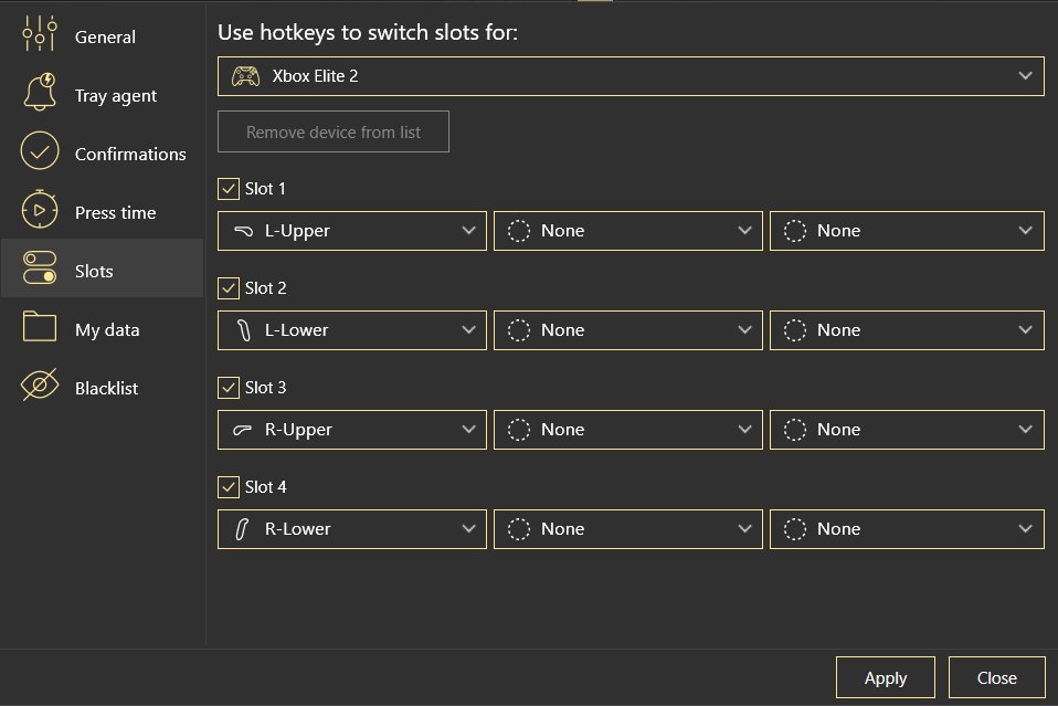

    I am trying to do this:
    It won't accept it because it needs to be at least 2 buttons. My aim is to have 4 profiles and be able to switch from one to another at any time using the paddles. I was originally planning to use the shift profiles in toggle mode but you have to switch back to the main profile before you can switch to a different shift profile. For example, I can't go from shift profile 2 > shift profile 3 directly. I have to toggle back to the main profile first. Does anyone know a work around?

      Thanks for the quick reply!
      Neither of those are suitable for what I want to do.
      I am hoping to use reWASD to set-up 4 different profiles for Elite Dangerous. For example, one profile for general flight, one profile for combat, one profile for mining etc. I want to be able to switch between these profiles using the paddle buttons. I can sort of do it using shift profiles, but the problem is I have to remember to toggle back to the main profile before I can select a different shift profile.
      I want to do this: Shift Profile 2 --> Shift Profile 3
      Not this: Shift Profile 2 --> Main Profile --> Shift Profile 3
      I could not find a way to do that, so I tried to do it with slots. Slots would be preferable anyway because I could then use addition shift commands within each profile. But I can't create a one button hotkey
      Where are the hotkeys saved? Maybe I could edit the file to get around the hotkey restriction?
