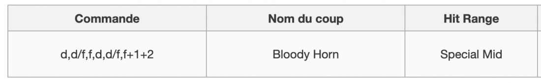

      Here's the move - The character is Eliza:
Name:	Screen Shot 2020-05-21 at 11.36.42.png
      I think the sequence is right. After all it does trigger the move sometimes, but not consistently.
