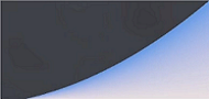

    I am sorry for my late reply, let me make one more guess
    Do you want the axes range to look like this?
    Also, can the speed of the mouse be doubled?
    Yes, this is possible. You should tune Sensitivity after you map your mouse to the stick here:

    I'm sorry, I still can't understand how the thing we have is related to what you are saying.
    Could you please describe what you want to achieve in the end? Any specific deadzone shape, any specific behavior for the stick that moves slightly?
    Axes range in reWASD just does what it does: shows and allows to change the zones in which the directional mapping is unique and in which zone it is summed up to use with digital mappings only.
    The purpose of this function is to ensure that the axis range is set so that the mouse moves completely horizontally or vertically within this angle range, while the mouse can still be moved to any angle of 360 degrees in the remaining range. Map the remaining angles outside the axis range to 360 full angles.
    For example, I set the axis range of 30 degrees. When I input -15 degrees to 15 degrees, it is completely to the right direction. When I input 20 degrees, the actual effect is equivalent to 7.5 degrees when the axis range is not set.
    The current axis range setting will lcause the mouse to lose the direction within the setting range.
