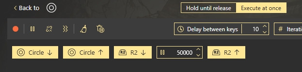

    Hi, I would like to make a "combo" where he pressed the circle once and then held R2 until I let go, is there a way to do this?
    LIKE A:
    "Hold Until Release"
    O↓O↑R2↓
    Please try the following.
    1. Create a combo with Circle and R2 with long pause (duration):

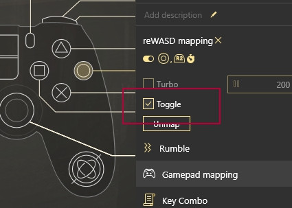

    2. Set it to Toggle:
    Now it will work the following way: when you tap Circle once, Circle is pressed and released, and then R2 is held until you press Circle again to stop it.

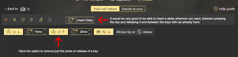

      I made a montage of what I would like to do including a suggestion that would be very welcome!

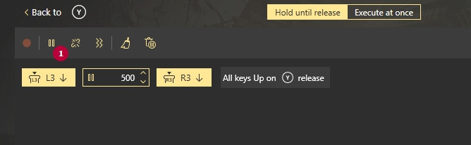

        You can use Pause (1) to add delays anywhere in both modes:
        However, it is impossible to add more than one same button in Hold until release mode. In this mode, all keys will be released in the end, so once you add L3, it will be pressed all the time the combo is active. In your case, you need Execute at once mode + Turbo, like I've described in my previous post.
          Wow! Very grateful for your help! It worked out what I wanted to do!
