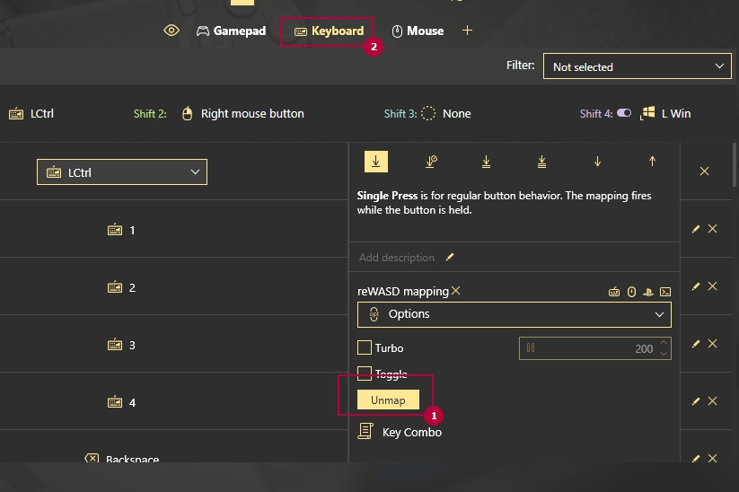

          Actually I'm slowly getting a hang of it but I think due to pressure exerted on certain keys, other keyboard keys are slightly activated and hence the game keeps glitching out. Between keyboard and controller in between I'd there anyway to unmap all keyboard keys except the ones I'm using, hence eliminating this issue. Because if I'm unmapping all keyboard keys except the ones mapped to controller only the controller keys would work. I hope you understood
            Not exactly. The main goal is to force keyboard and mouse to act as a controller, so unmap is required to mute the keyboard inputs completely and the game sees the controller only.
            Why do you need to use keyboard buttons in the game if you use a controller? So, I wouldn't recommend using the multiple inputs cos it could be a reason for glitch.
              I use the virtual controller on the keyboard, I don't have a controller, but when I press multiple keyboard buttons in game ,it glitches and for a second or so switches to keyboard input, thank you for your time and kindly help me with this

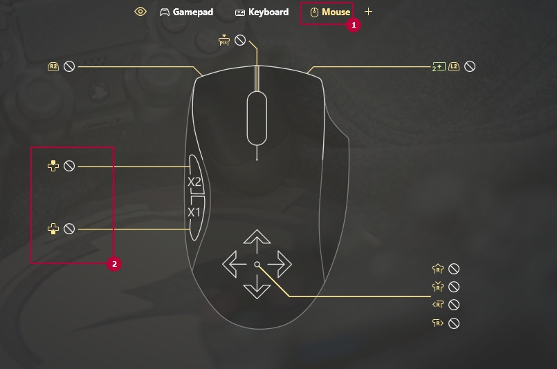

                Update: The app seems a little complex and I'm figuring things out, I'm unable to remap anything to my mouse button, I did bind key pad up to a building button and then remapped my d pad up to a mouse button but it's unresponsive and doesn't seem to work
                  Please ensure that you have "Unmap" for all keyboard keys you use. It will block the keyboard input, and there won't be any glitch:

                  As for an issue with a mouse, could you please show me what do you see in Mouse sub-config? Is it the one where you add controller mappings, right?
                    I added controller mapping for mouse both in keyboard and mouse as the option was available for both

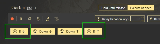

                          So, the combo should be something like this:
                          B is pressed but not released, then D-pad down works, then you release B button.
                            It didn't work. You need to press the build mode button only once, you don't need to hold it while building. You can press the build mode button once, and then use only d pad buttons to keep building. Furthermore if you press the build button again it exits you from build mode and the d pad buttons won't function without entering build mode again. There lies the complication. Is there any way for me to use only d pad buttons to build Instantly Instead of entering build mode everytime
                              I don't think that it's possible as to build walls you need to be in build mode. Perhaps you may try to use activators. Set B to Start press D-pad down to Single press WITH Turbo B to Release press.
                              In the game after you press\hold the key, you go to build mode because of B on Start Press, then D-pad down to build continuously, and when you release the button B reproduces to get you out of build mode. So you go to build mode, do buildings, go out built mode with a single button - https://recordit.co/6bKeOT6ybF
