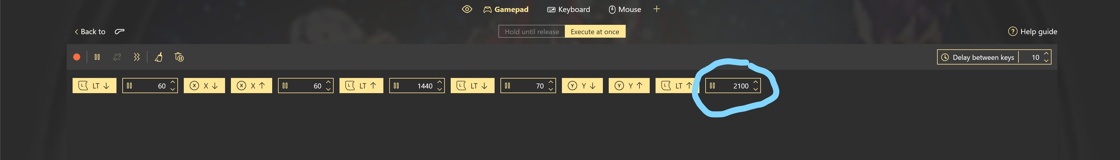

    Hello all. I am trying to figure out how to make my combo repeat while hold the button down. If anyone can explain how this is done, I would appreciate it. I understand I can do iterations, but I am not looking for that. I am more looking for, if single tap perform combo once, and if I hold the button, it repeats untill I release the button.

    Use "execute at once" mode with turbo. The steps are the same but also check the "Turbo" option. Here is the link of both ways - https://recordit.co/ijxFSLA1R7. Note, RapidFiRapidFire option is required for turbo.
    So, the combo triggers if you tab the button once or triggers repeatedly if you press\hold.
      Thank you again Star Lord for responding. I was using that, but couldn't get it to work. I figured it out now though. I used the rapid fire, but what I was missing was a delay at the end of my combo to when my move finished to restart the combo in the correct time.
