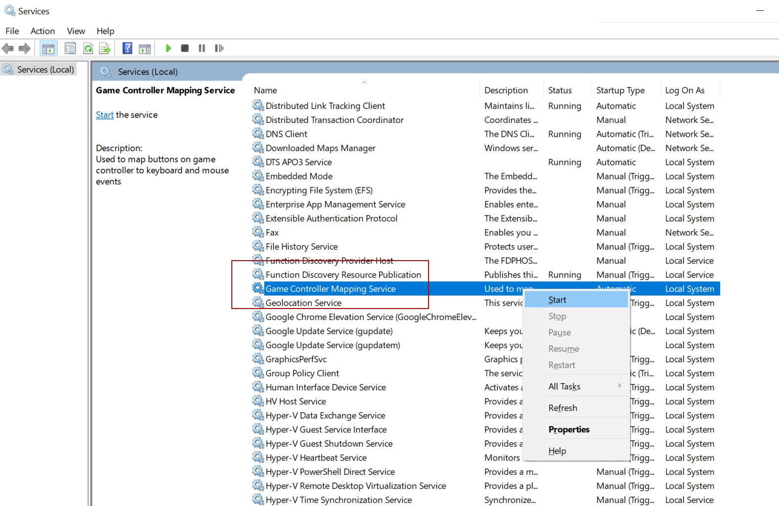

        Please go to Services (just type it in Windows search) an find Game Controller Mapping Service. Try to start it manually from the context menu. Do you get any error?

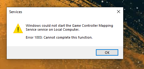

          I got this error message
            Thank you. May I also ask you to send the logs that were created after the installation?
