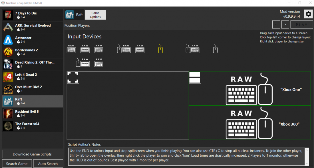

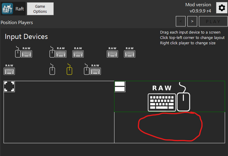

    I try to explain what I want to do.
    I want to Play the Game “Raft” with Controller, but not alone. There is a Program out there called “NucleusCoop” it makes it possible to play “Raft” with my Girlfriend in Splitscreen.
    The Problem is, only Keyboard and Mouse worked in this Game.
    We need two separated Controller, that means is there a possibility to have for each Controller one virtual Input device? Because the Program “NucleusCoop” is detecting the Devices of the Computer. If I install your Program than only one now Keyboard and Mouse is shown in the list. But I need for each Controller one new Device Input. Can your Program realize what I want to do?
    Attached is a Screenshot of what I mean with input device in the Program. The red Marks shows that two new Devices are detected for your Progam. The Problem is I can not use the Controller separately. Only If your Program would detect each controller as one new Virtual Input Device.(Xbox 360/Xbox One)

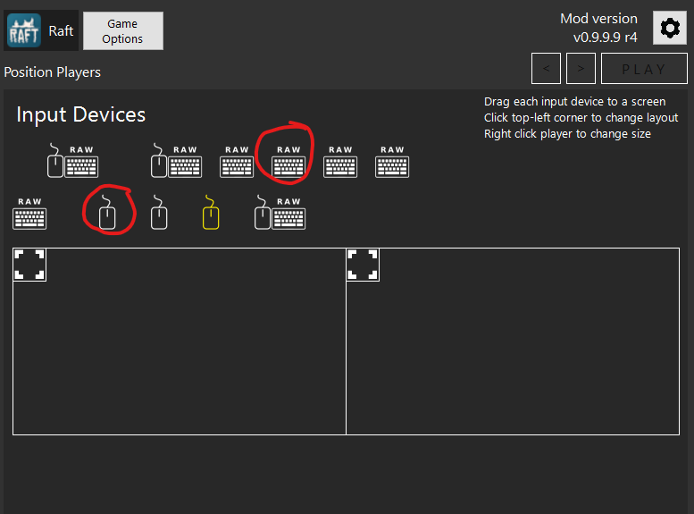

    Usually I can drag and drop the Controller I want so in this Case the Keyboard and Mouse I want in the corner of the Splitscreen for each Player. But now I need for the second Controller also a seperate Input, in the Picture below marked as red.

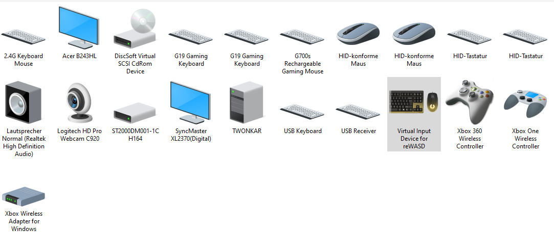

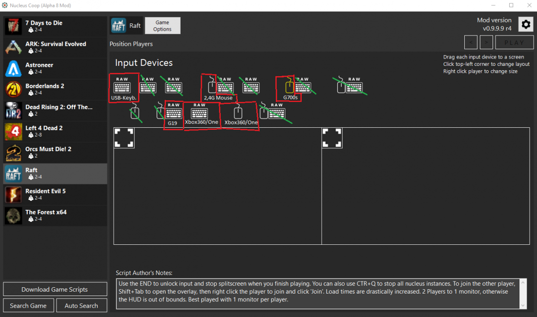

          I connect another Keyboard and Mouse, here a Picture of my Devices. You can also see your Program is in here as a Virtual Driver once! Don´t ask me why many of this device shown twice. I Try to reinstall all but its al shown like this.

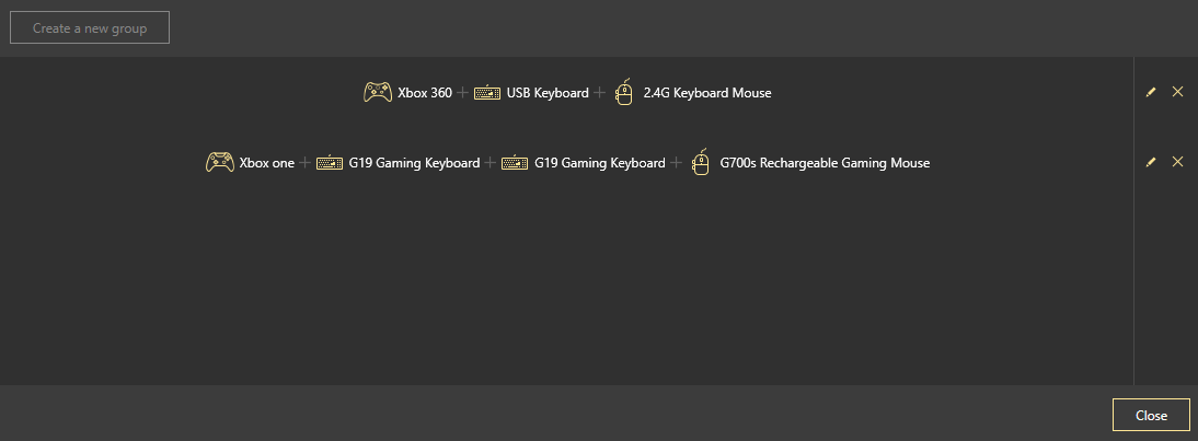

          But I group them up like you said, here you can see what I did.

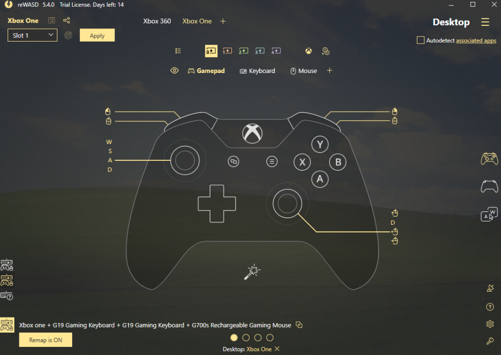

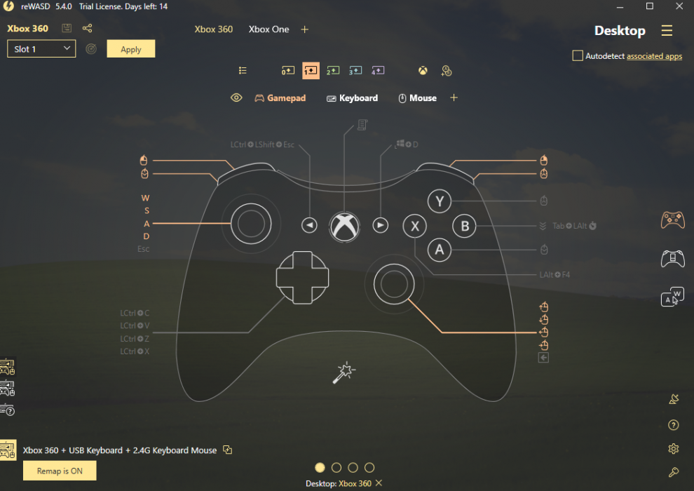

          Here are the Settings, just for a try I make a basic control.
          The Problem is, that the Program “Nucleus Coop” don’t detect the each Controller as a Keyboard and Mouse. There are not Separated, here is a Picture of that Problem I marked the not used green and the useable Devices Red. But you can see both Controller are recognized as the same Keyboard and Mouse. I think I need a Virtual Driver from your Program for each Controller that it works. Or I do something wrong or I need a Upgrade to buy from your Program.

            Usually It should look like that. Each Controller has there own Keyboard and Mouse "virtual driver/input device" for playing splitscreen.

              Why do you need yo combine the devices in the reWASD? As I understand the “Nucleus Coop" combines then together while screen splitting. Devices are highlighted when you pick them. So, you split the screen, pick keyboard and mouse - > drug to the one side of the screen. Pick another keyboard and mouse and dru&drop to another side - > Launch the game.
              To use the controller you need to unmap it completely and then set the keyboard&mouse mappings. This is what I did - [link expired] (the remapped controller was added at first, then keyboard and mouse) Does it make sense?

                Now I also captured the Screen:
                [link expired] The Problem is I want to use two Controller each should shown as a separate Mouse and Keyboard.
                • Player one (Top of the Splitscreen) use the Xbox One Controller
                • Player two (Down of the Splitscreen) use the Xbox 360 Controller
                But Its shown in “Nucleus Coop” as the same Mouse and Keyboard even if I unmap them and I plug in a second physical Mouse and Keyboard set.
                You can see in the video, the Problem. Is there a Possibility to get a Virtual Keyboard and Mouse set for each Controller separated?
                  For some reason, I decided that you going to use controller and physical keyboard\mouse and the utility can't detect the controller as KMB. Sorry about that. Everything is clear now and I'm afraid that reWASD won't help.
                  reWASD creates all mappings within a single device virtual input device for reWASD no matter how many controllers are connected physically and remapped to KMB.
                  So, in your case, the best option is controller + one of your physically connected KMB. 2 separate controllers ( Xbox One Controller and Xbox 360 Controller) are detected as single input KMB device not 2 ones (in our case it looks like - https://prnt.sc/tb2e8k).
