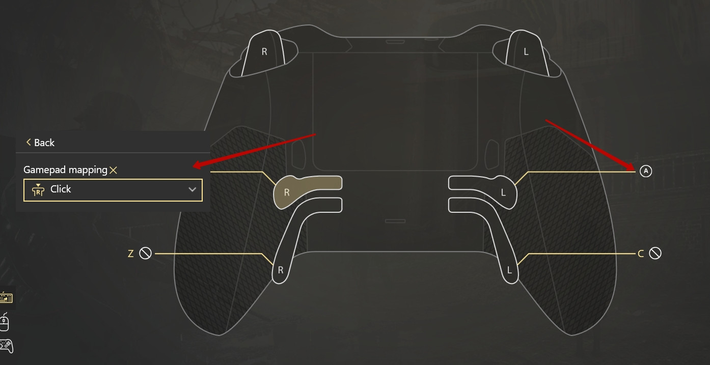

    At the moment, you are using the virtual controller, and it seems that the game doesn't recognize it at once. You may need to press Apply before the game and all its launcher(s) opened.
    However, in your case, it seems to be better to use the physical controller only, and add keyboard actions to your paddles. This is what you have already done for С and Z.
    For two other paddles, use Gamepad mapping section instead of reWASD mapping (you will see white icons):
    Click image for larger version  Name:	3e9c4e9f8f.jpg Views:	0 Size:	113.5 KB ID:	220475
    As you may see, there are no additional mappings on the controls that should be left as is.
    I've attached a config too, hope it will help!

      Thanks, I will give it a try. In this particular case, I didn't actually want Z and C mapped, tha was just a screenshot after I'd added keyboard binds to test something.
      I had already tried relaunching the game (Fortnite) and epic launcher itself (Used to launch fortnight) but still no joy - but sounds like it could be because I was doing it wrong. Will test your profile and report back .
      Thanks again
        Please, the attached by reWASDer config file without a virtual controller. Download - > select the controller - > apply the config - open the game. In case you don't need the Z or C keyboard bindings you may replace to controller one, but select the gamepad mappings for paddles re-assign.
          Apologies for the delay in reporting back - everything is now working as it should, many thanks
