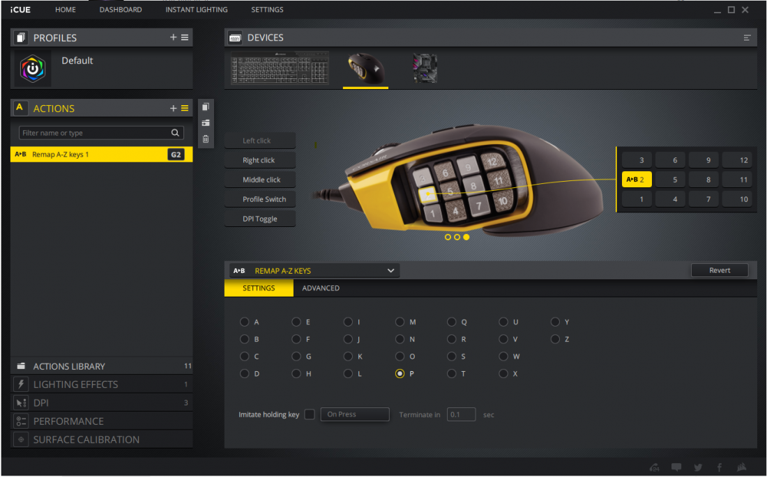

          I'm still struggling to remap my mouse button keys. For simplicity, I've assigned one of the mouse button keys to "p". Then, I've remapped "p" to execute "2" within reWASD. I've saved, then applied. I then open notepad to test it. While pressing "p" on the keyboard, it correctly produces "2" in notepad. When I press the mouse button, it executes "p" still. Any suggestions? Thank you!
            I think you need to remap the mouse button to "P" in the native software, then, open the reWASD - > select mouse - > Additional mouse buttons and remap "P" to "2".

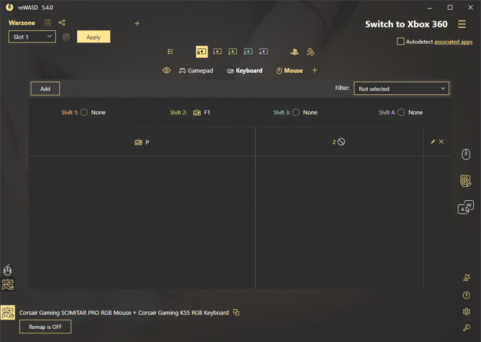

              I have remapped the mouse button to "P" in the native software. When I press the mouse button in notepad, it produces "p". Here is a screen shot of the native software. If I press "P" on the keyboard, it produces "2". If I press the mouse button, it will only produce "P". Any help would be greatly appreciated!
                Thank you for your feedback.
                According to the screenshot, the keyboard and mouse are in the group. How do the mouse&keyboard are connected to the PC, separately, or use a common USB hub? May I ask you to ungroup devices and do exact steps for mouse only.

                Also, is there an On-Board Memory option in the native software? It should be set by default.
                  Hey Star-Lord, thanks for the help with this...
                  So the keyboard and mouse use seperate USB ports. When I used the on-board memory option with my native mouse software, it worked! When using notepad if I press the mouse button which executes "P", reWASD correctly changes it to "2" in notepad. The problem now is actually in COD Warzone. When I press the mouse button, it still doesn't work... The game screen flickers briefly like it wants to switch to keyboard and mouse.
