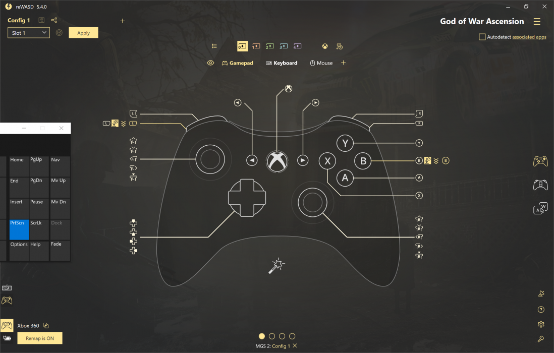

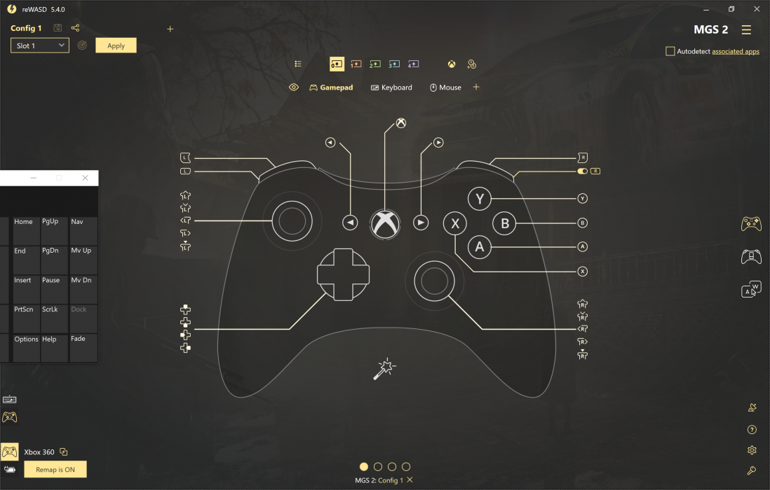

      Here are the configs that I use:

        *Xbox 360/Xbox One controller
          Could you also show advanced settings of stick mappings too? Or maybe upload the config files here? You can find them at C:\Users\Public\Documents\reWASD\Profiles\

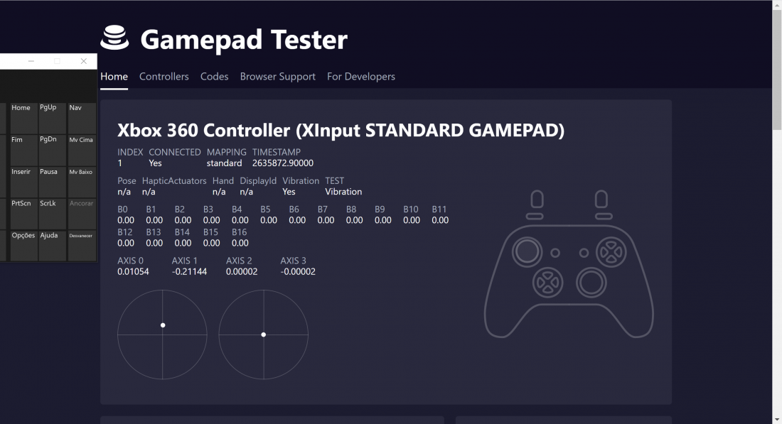

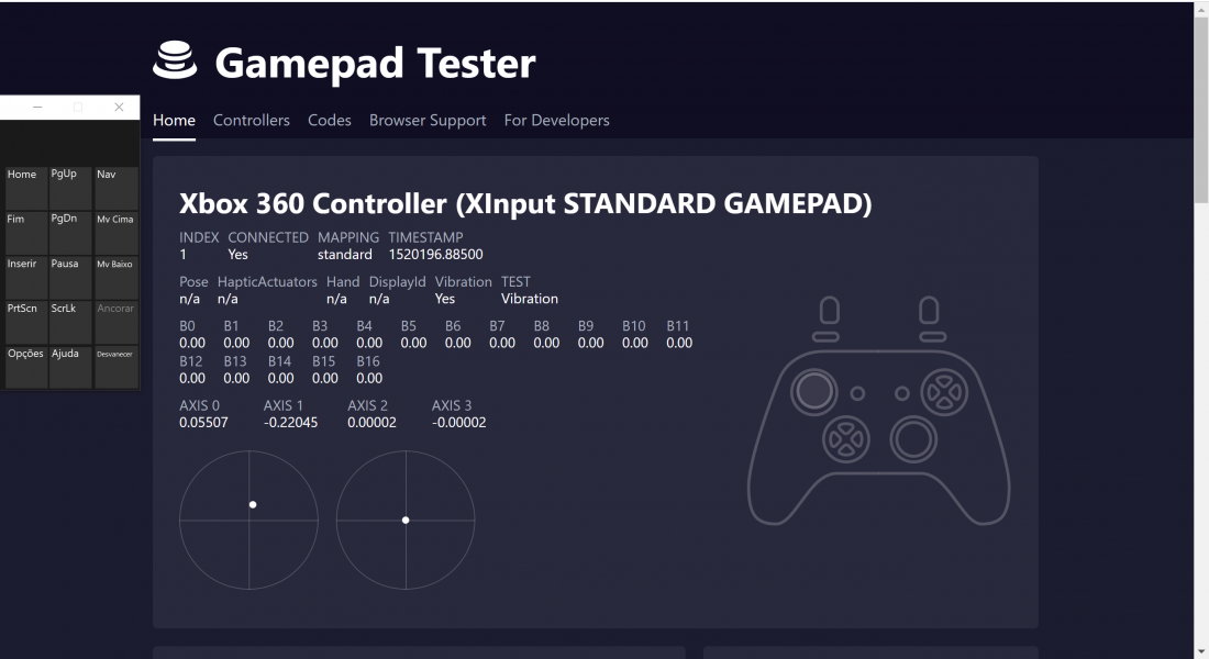

                1 - Connected the controller and used the analog sticks. Worked fine.

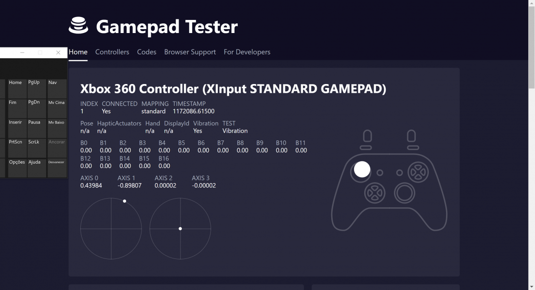

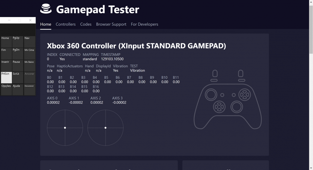

                2 - Turned remap on. Weirdly worked fine.

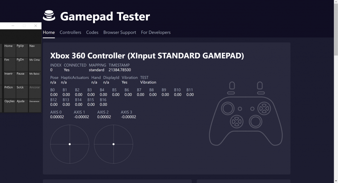

                3 - Turned MGS2 on, entered in the game and I started moving around. The issue started happening. (These pics were taken after releasing the analog stick)

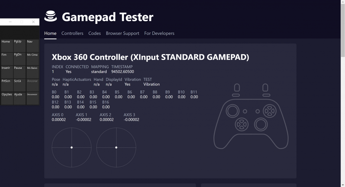

                4 - Closed the game but the issue continues to happen.

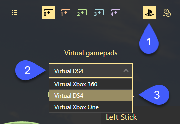

                    Please, set "Virtual gamepad" to DS4 in reWASD settings, apply config before starting PS Now and check if the issue persists.
