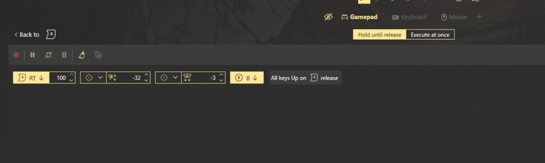

                    hey, sorry! i ended up figuring out that i needed to have the controller on prior to the game exe open for the game to see the controller correctly. game is warzone, controller is elite 2. After the update though, i am having another issue, however. i have a combo running on a trigger that was working prior to the update, but now instead of ending the (all keys up on R), the trigger continues to fire like it's being held in. any thoughts?
                      What combo is that? Can you either screenshot it or share your config file in some way?

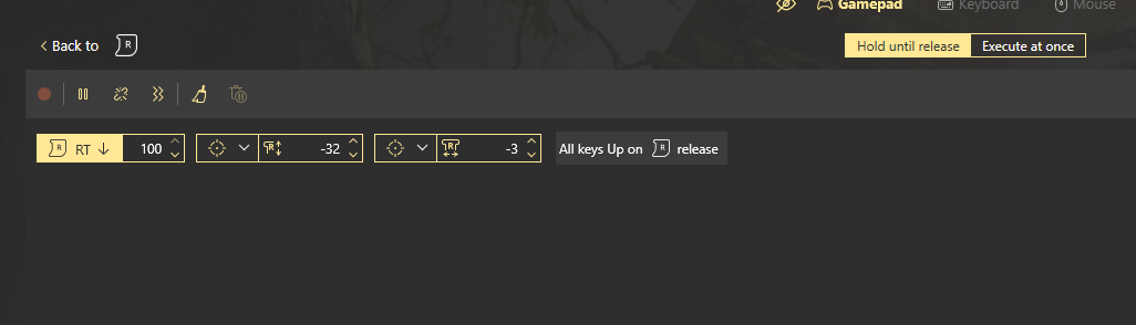

                        yeah, here is the screenshot of what worked prior to latest REWASD update. now it just continues the R trigger down action, even after release. i have tried deleting and making it again with the same results.
                          i've tried modifying the "100" next to the R trigger action but it only seems to work at 100. also, i don't see it working correctly on gamepad tester either. however, a double tap one works fine:

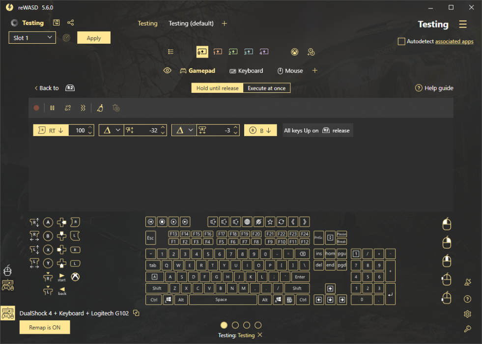

                            Was unable to reproduce with this combo. Can you send/share the config? You can find it here by default: C:\Users\Public\Documents\reWASD\Profiles\
                            On a side note I'd suggest using [Relative deflection], as any right-stick movement would reset that recoil-compensation:
