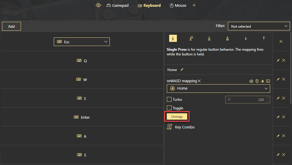

              You should [Unmap] all the keys. The game probably gets input from both keyboard and gamepad, resulting in this behaviour.
              [Unmap] is a part of [Advanced mapping] feature and requires either a license or a trial period to be activated.
