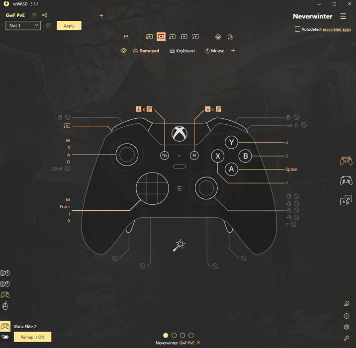

    I'm having difficulty in using Shift1 on LB (held down till release) while using LeftStick as WASD for walking or sprinting in-Game ( MMO-RPG )
    every time i press LB (shift1) while walking to use another (layer) button to jump ( A button ),,, it pause immediately, till I re-Move LS (WASD) to walk or RS (Camera Mouse), then it active Shift1 layer to use whatever button assign to that layer LB ( Shift1 modifier ).
    even when i release LB (shift1) it does the same thing.!
    I tried to assign WASD to the 2nd layer to make it work. it doesnt fix it.
    here is screenshots of my config. I would appreciate it if there is any help or support into this matter.

    Hi there,
    Tried to reproduce reported issue. Indeed W stops triggering but resumes triggering again. No need to release the stick or re-press the shift modifier.
    May I ask you to reproduce the issue out of the game, via notepad for example (made screenshot where you may see pauses when LB press\release while stick deflected in full. Also, I mapped the A = space to see mappings inside shift).

        Based on your screenshots, we could not reproduce any issues with a mouse. Once I press LB (and go to Shift mode), my mouse still moves. So maybe there is something we are missing in your setup, so the config should be the first step Also, we are checking the behavior on the desktop, so could you check it without a game too to see whether it happens on desktop?

                Hey there! After a bit of testing with a game, I see what happens here.
                Once you go to Shift, reWASD stops the emulation on a stick and restarts it again. Neverwinter clearly sees that the emulation has stopped, but seems to be too slow to detect the newly restarted action. If I add a small pause before each directional mapping, the game has enough time to detect it, and so character doesn't stop once you go to Shift or return to Main. I've attached a slightly modified config, and hope you will give it a go.
                There is one funny side effect. If you go to Shift and back pretty quickly, you may accidentally launch a double movement which results in a special movement in a game. I hope it won't be a big problem for you.
