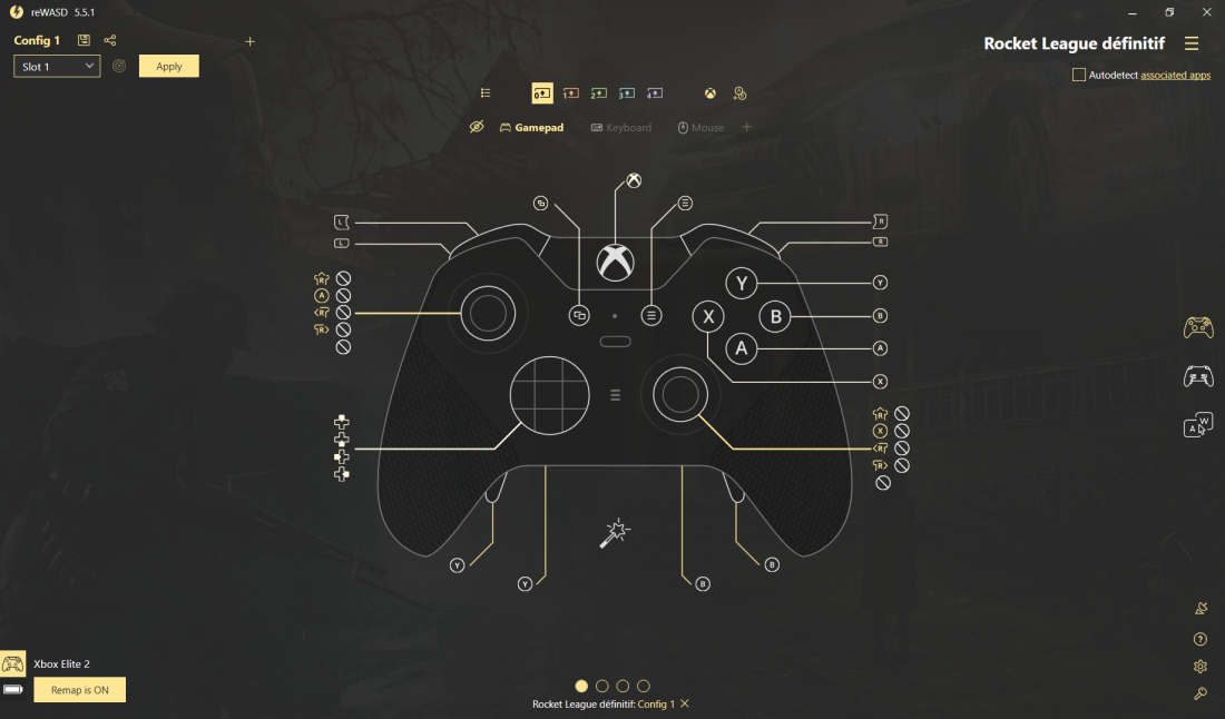

    On my elite 2 axis ranges won't apply to the sticks. Trying this on Rocket League.
    I can only make the settings work if I bind one of the directions to a button, then other axis ranges are applied to the stick. But I need to use all four joyatick inputs with axis ranges and I'm stuck.
    Here's a pic of my config that won't work if I don't bind A and X to down on the sticks.
    Thank's for any help

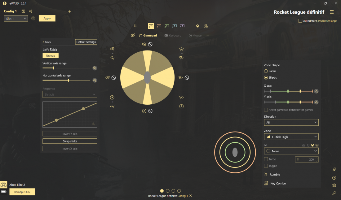

    Axis range option is for digital buttons or keys mapped to the stick only, so yes, it doesn't influence a virtual stick.
    We have tested these functionality internally, and came to the conclusion that stick becomes pretty intermittent with any axis range > 1. In this case, stick loses its analog mode, and becomes a kind of a digital control. Is that the thing you want to achieve?

        In the upcoming version, we are adding the "digital mode" for sticks. Once it is enabled, you will be able to change axes ranges, and they will influence on the virtual stick. I think we should start from this functionality, I hope it may work for you. So, stay tuned, will be happy to let you know once we release the next version. It is scheduled for the second half of November.

              We have released reWASD 5.6 that includes a Digital mode for sticks, in which you can add 8 separated mappings to the directions and diagonals of a stick.
              Would be grateful if you could check this feature after the update
              You will need to go to Advanced section for a stick and check Use 8 digital directions option.
