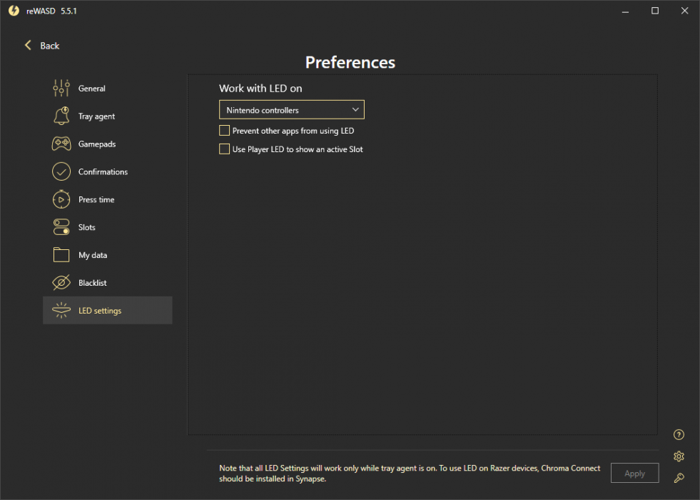

    It might be a known issue we have a temporary solution for:
    Open [Preferences > LED settings], select [Nintendo controllers] and disable both [Prevent...] and [Use...] flags there.
    The issue will be fixed in the upcoming 5.6 release.
