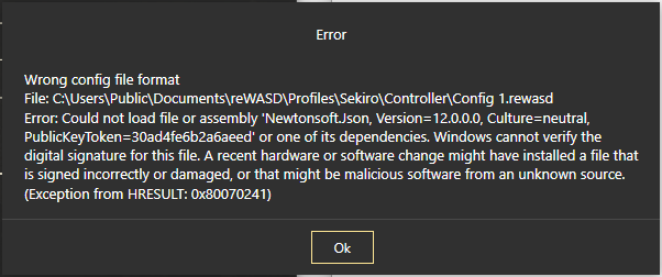

    I've used reWASD for nearly a year without any issues. About a month ago I got a second NVME drive, configured them in a RAID 0 array and reinstalled windows. After that I started getting the "Wrong config file format" error whenever I connect my controller or attempt to apply a config,

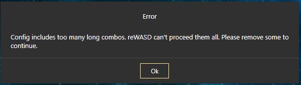

      Always the same error. Sometimes followed by another pop up that states that there are too many combos mapped, but I don't have any mapped at all.
        Here is the second error-

              Hi there,
              This is an error that definitely comes from some issues with the JSON library. Unfortunately, at the moment, we can't reproduce this error from our side.
              I would ask you to share the config u are using (сonfigs are stored here: C:\Users\Public\Documents\reWASD\Profiles I need the correspondent *.rewasd file).
              But, I think, the better way is to format the drive and install fresh Windows 10.
                Hello there!
                We got an update regarding the issue you were facing with. Please enter the following path:
                C:\Windows\Microsoft.NET\assembly\GAC_MSIL\Newtons oft.Json\v4.0_12.0.0.0__30ad4fe6b2a6aeed
                And remove the Newtonsoft.Json.dll file contained in it. The similar case was just fixed, it may also work for you.
                Also, please make use the Explorer search to find all the Newtonsoft.Json.dll files contained in your system folder (C:\Windows and all the corresponding paths).
                Feel free to share a screenshot of files that are found there.
