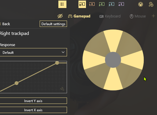

    Currently reWASD is the only way to play Cyberpunk with the Steam Controller. It's working well but it's hard to use without the trackpad rotation that steam offers. It is possible to rotate these directions?
    Also are there plans to add other steam controller features in future (e.g. trackball mode) or is the current feature set finished?
    Many thanks,
    Gerry

      That's great to hear. At the moment I'm using external software to change the orientation of the mouse in Windows lol. But then the gyro is off. I think those even those two features would make it feel a lot more complete for most people. Keep up the good work!
