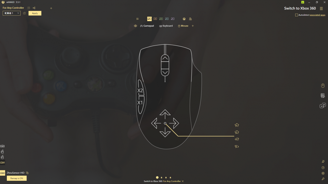

    I am using the app for my game controller, and the turntable let the cursor move up and down. I want to set it as controller move left or right. But when I using it to the game, while I spin my turntable to a direction, it was like clicking it like crazy instead of holding it. What should I change in the setting to let it hold instead of clicking crazy?
    Hi there,
    I don't know if I get you correct, but you have some device (turntable), connected to a PC via some software that transforms turning to a mouse moves. Do you need to remap this mouse move to a stick move?
    1. May I ask you to specify more about the turntable (what is a device, how it's connected to the PC, how detected in the reWASD) how it's remapped in reWASD?
    2. What do you remap in the reWASD?
    3. Some screenshots or videos are appreciated.

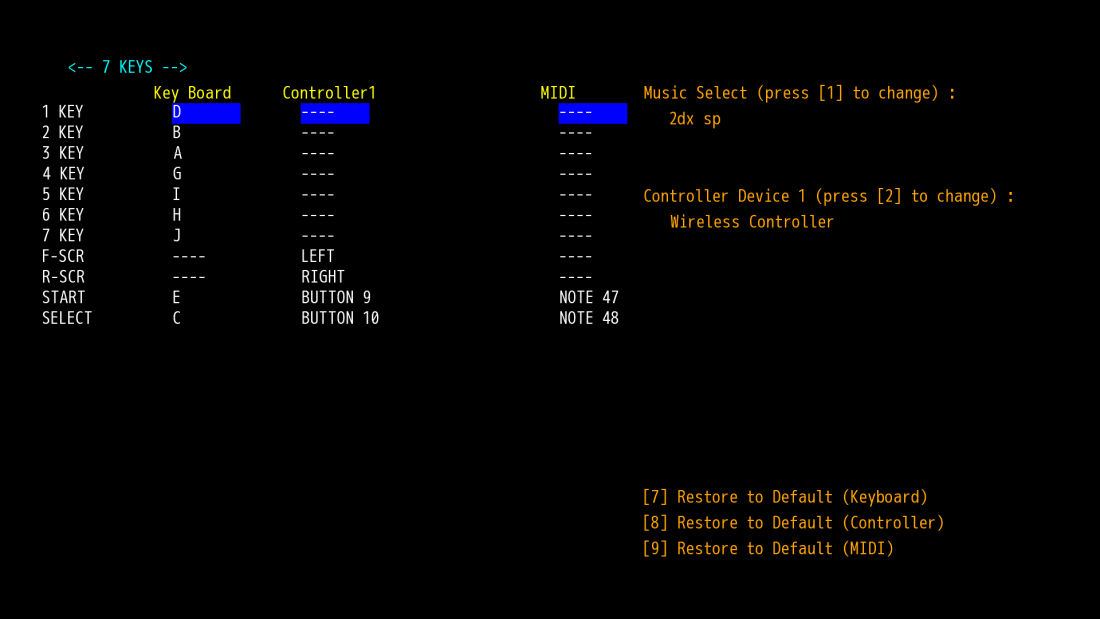

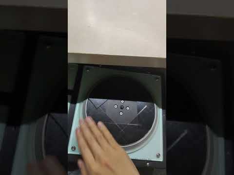

      It's a controller for rhythm games, and it connected by USB. It was detected as a mouse and a keyboard. I use it in beatoraja, a rhythm game.

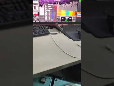

        1. Thank you for your video and screenshot. First of all, please update the current 5.5.1 version to ver 5.6. Try to reproduce the problem.
        2. I'm still puzzled about the "clicking like crazy instead of holding". When does it happen? May I ask you to make a video, as you've done but with the reported issue? Is the sound in the video is the clicking you're talking about?
          In the game, if I spin the turntable at the same direction, it should be detected as holding, but at the 0:06 of the video, you can see it detected as clicking multiple times instead of holding.

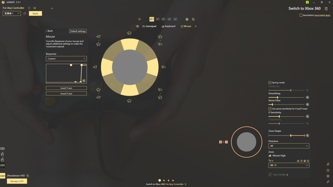

            Spinning left and right with this device makes the mouse cursor moves up and down. The mouse is remapped to stick in reWASD, so the game should detect the stick deflection instead of a mouse.
            1. Please, open the "License" tab and activate the advanced mapping feature (screenshot).
            2. Select the PS4 remote play config and unmap the mouse (screenshot)
            3. Apply config. Now, spinning moves should be detected as a stick deflection in a game. Try this and let us know if the problem remains.
