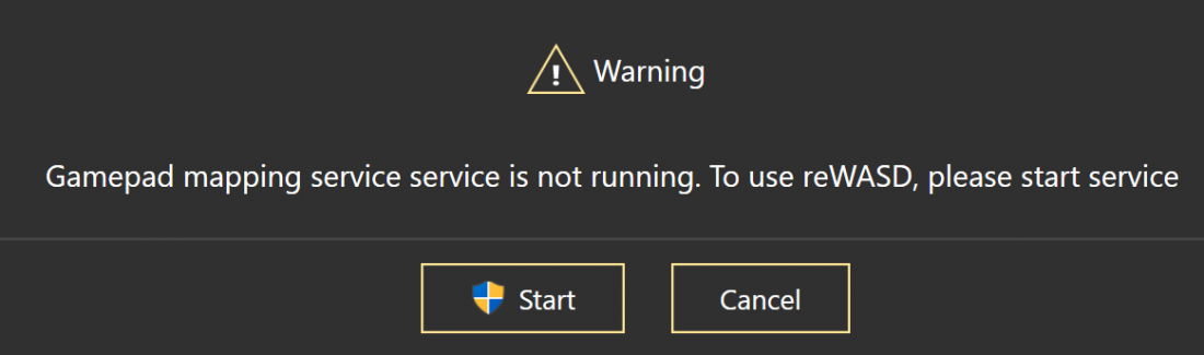

    Mapping service is stopping at least one time daily since last update, suddenly can't move ingame and when hitting "apply" in rewasd, this is the message i get. What can I do?
    High chance the service crashed for some reason.
    Could you, please, follow the instructions in this article? Make sure to catch the sudden service shutdown while collecting logs, or they will be useless.
    Would also be nice to have application logs from Windows Event Viewer right after that. To get them: start the [Event viewer] (just type it in Windows Start Menu), select [Windows Logs > Application], right click on it and then [Save all events as...].

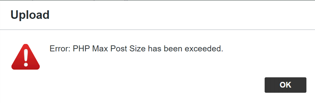

          I can't upload log files due to PHP file size limitations, what can I do?

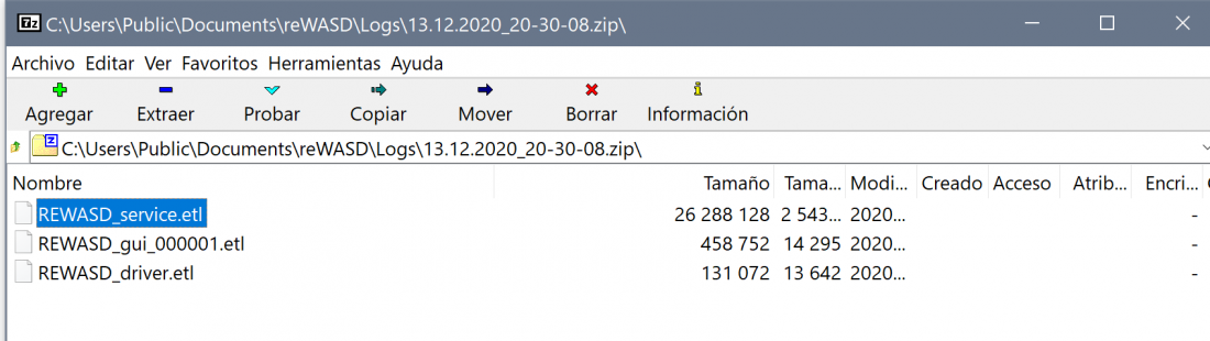

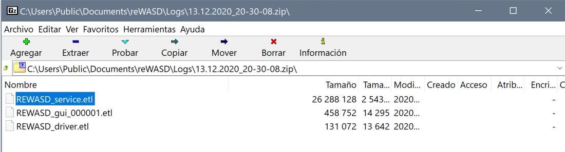

            I can't upload log files due to PHP file size limitations, How can I send them?
              Does this help?

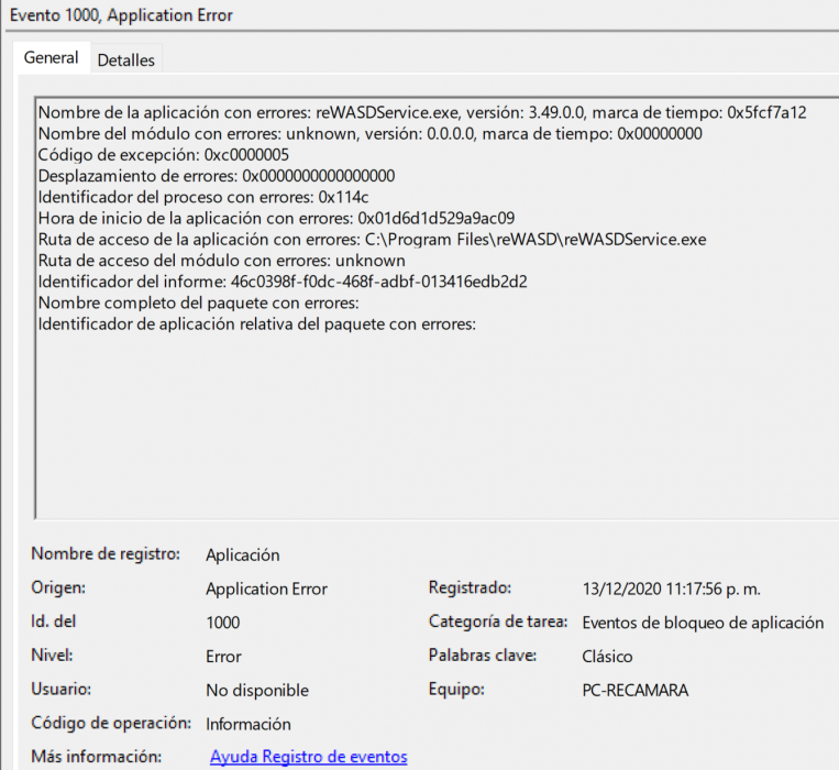

                Thank you for the screenshot with Event Viewer.
                Error 0xc0000005 is an error caused by an access violation. This means that whenever you try to run a program, Windows is unable to properly handle the files and configuration required to run that particular program. It's a system problem so, recommend following standard steps to resolve it (like this link).
                Any recent system updates that were applied?

                  Three more errors popped up
                    Checking the attached file I also found the 0xe0434352 exception error which related to the .NET framework. Here are possible solutions to resolve this exception. Also, proceed with steps described above (this is a link if you didn't notice).
                    To learn more about the crash I would recommend collecting user-mode dump. Here is description how you may arrange that -https://docs.microsoft.com/en-us/windows/win32/wer/collecting-user-mode-dumps. Hence, each next crash happens in further will be logged more detailed.
