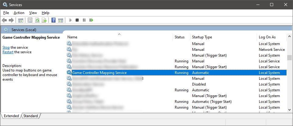

        Is our service [Game Controller Mapping Service] still running when that happens?
        Click image for larger version  Name:	image_2020-12-13_222450.png Views:	0 Size:	69.8 KB ID:	222808
