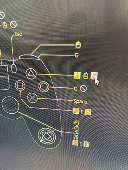

    When using plates in warzone on ps4 controller without remap holding the button would apply plates until I let go. Now with rewasd it only does one at a time and have to wait for the animation before I can add another. I am using the same in game settings as if using non rewasd controller. I have added a pic of my mapping the Triangle button serves as two functions. Tapping swaps weapons which is mapped as a mouse scroll. Applying plates is a triangle long hold, which is key 4 as mapped under that hold command.
    Im at a loss and have searched and searched. Can anyone please help a guy out?

    I am checking the same mapping without a game, and it seems to be working correctly. If I press and hold Triangle button of 500 ms, I get "4" and then reWASD emulates the pressed 4 all the time I hold Triangle. Are you sure that you need to press and hold "4" to get the desired behavior? Maybe, there is some other mechanics?
