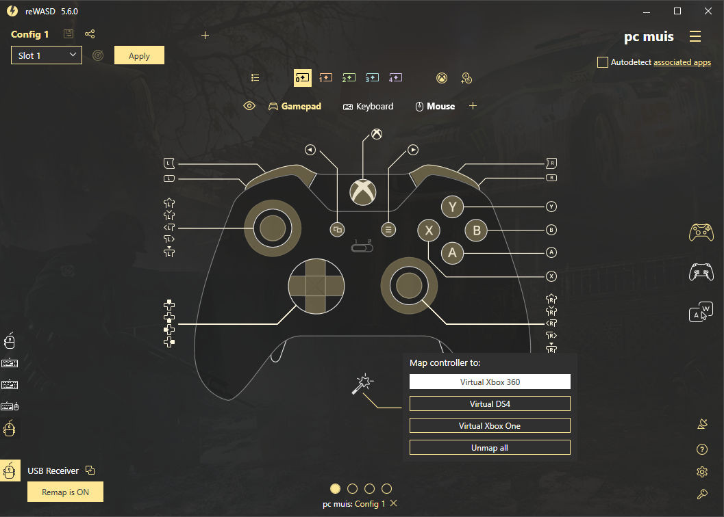

    so what i did was i made a virtual controller...or i assume i did! like so

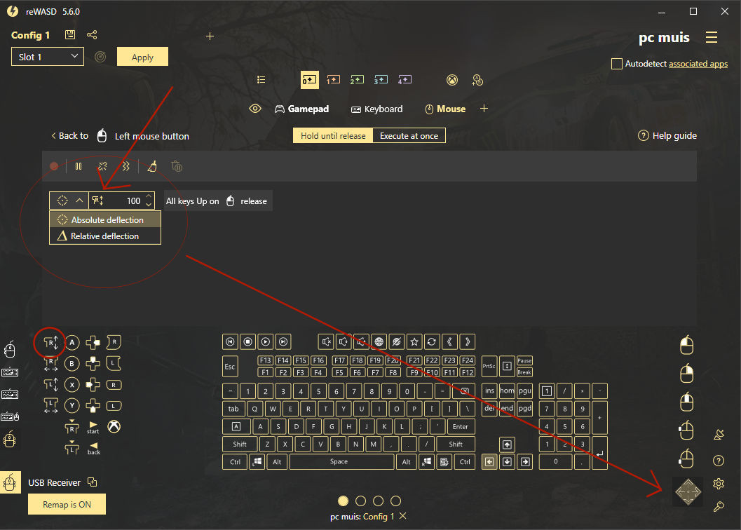

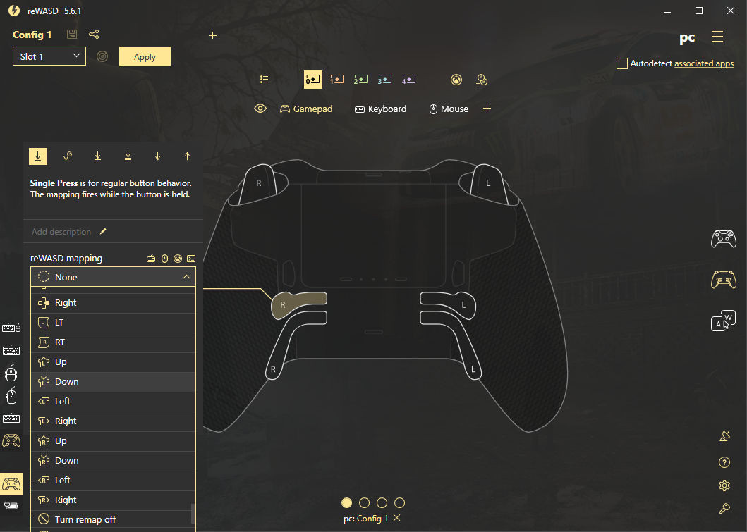

    i selected my A button made a combo for left click+ right thumbstick up and down

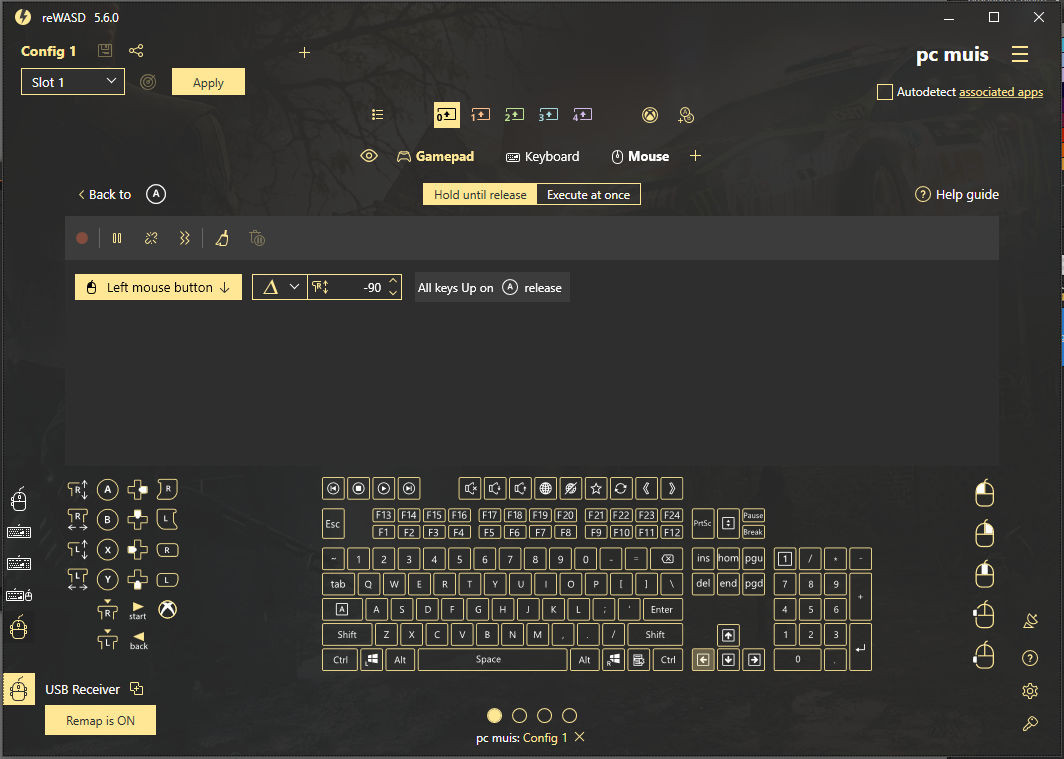

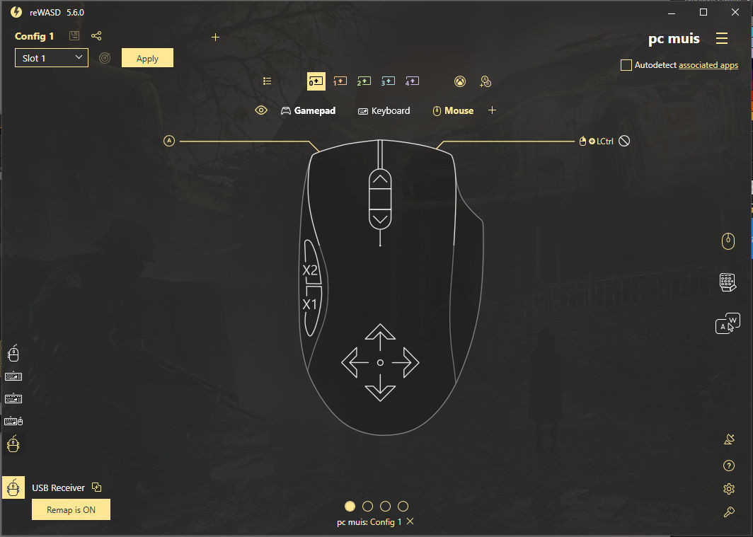

    went from gamepad back to mouse setting and applied button A to my left click
    is this suppose to work now? because it does not work for me i am trying the weirdest things but the solution does not come to my mind

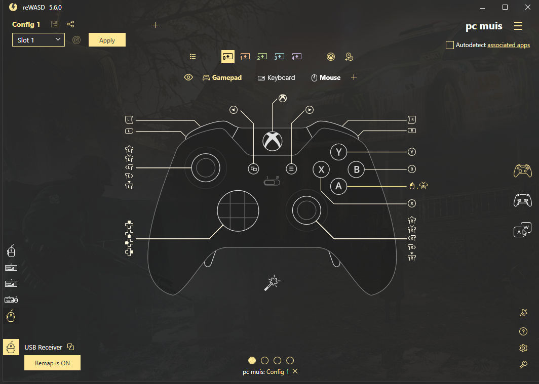

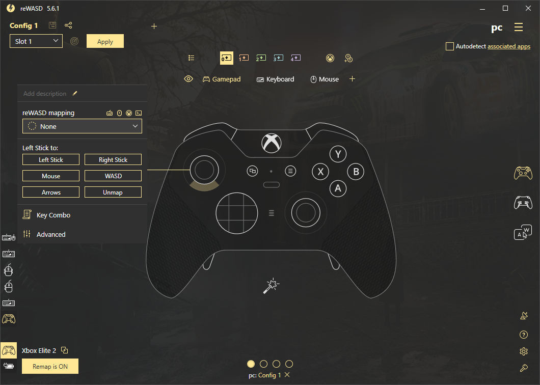

    and find it kind of complicated to setup it might be easy when you done it ones but this next pic could make it easier at least made more sense to me if it was like this
    what i find weird is that i get only get this deflection option when i select a stick in the first place what if you would take the mouse x,y axes logo put it to the right side where the mouse stuf is just like you did to the left with the gamepad stuf and add the deflection option to that so it is directly to the mouse without having to setup all kind of virtual controllers witch for me is a pain in the butt why would you have to be forced to put a virtual gamepad on your mouse instead for example give me the option to make a virtual mouse witch would make more sense
    or just what i said place a button for the axes in the right corner and let all this virtual setup stuf happen in the background so i just have to set the deflection rate's left right up down
    i mean its a nice piece of software and actually very clear i figured everything out i wanted to know very quick and made sense this is just the only thing that does not make sense to me because i have to add a controller button to a mouse.....

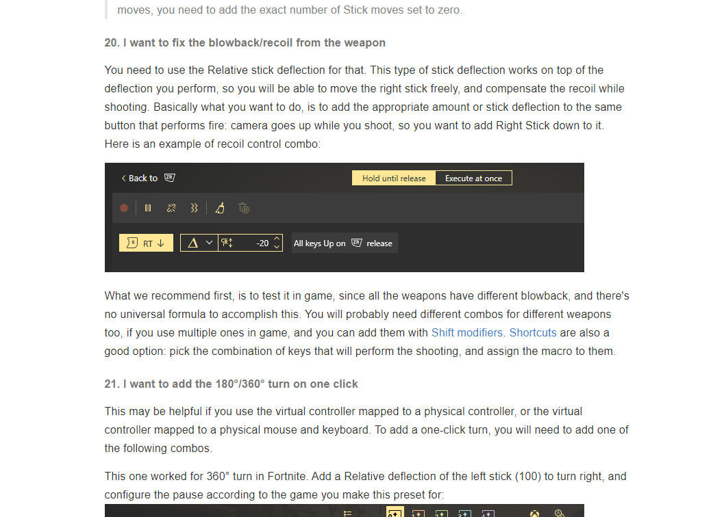

    There are a couple of things that I would like to mention here.
    1. Regarding the 'Virtual controller'.
    If you use reWASD for any purposes for your gamepad, it will be always virtual. As the virtual gamepad is being always created by reWASD. This is how our software works. By clicking the 'Magic Wand' button you just make the quick remap. You can do the same by clicking and remapping each buttons separately.
    2. If you want to make the recoil control combo, you should use the gamepad button which is used for shooting. Usually it is RT for Xbox controllers or R2 for DualShock. Additionally to that you should use the right stick movement opposite to your recoil. So if it goes slightly up, then with some delay to the left, in you combo you should use the Right stick down ('-' value), then pause and then to the right ('+' value).
    But on your screenshots it is not RT, it is mouse, which should not be used as the mouse click will be pressed, not the gamepad shooting button. And on the last screenshot there is just a movement with no RT.

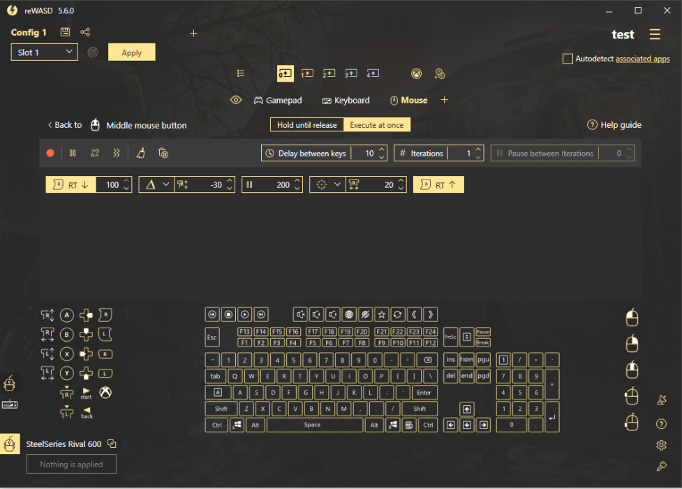

    By the way, you should put the stick movement after the RT is pressed but before RT is released.
    RT Down is press, RT Up is release.
    Or you can use 'Hold until release' mode, of course.
    Click image for larger version  Name:	1.png Views:	0 Size:	529.3 KB ID:	222958
    You can read more about that in this article.
    According to it you can see that:
    Absolute deflection just sets a stick to a certain position. Once you move your physical stick, the combo will go back to zero, and now your stick will have a higher priority.
    Relative deflection is summed up with all other stick movements you have. So, if you are moving your stick, the relative combo will be added to your movements. For example, this is the only way to create a recoil combo.
    Mouse anti-recoil combo is not yet possible as Key Combo does not support the mouse movement, yet.

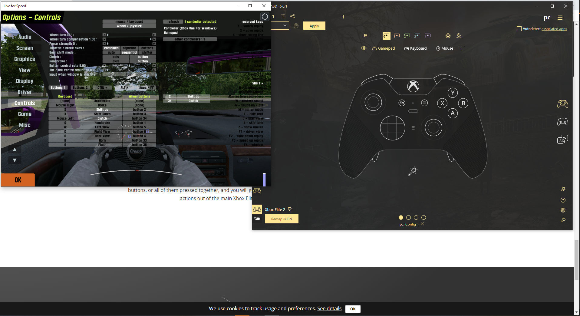

                aah i understand! thanks 1 more question i do have for example i play gta5 when i ride o na bike when i want to make wheelie (ride on 1 wheel) i have to pull my stick back hold it back and if you want to turn you stil have to hold it back for example i want to bind stick down to a button it does not work is that because A is not a stick and can not do a stick funktion?
                when i add numbers or so to the pedals it does work but not stick function its left stick and i tool left stick down and up i tried but it does not work

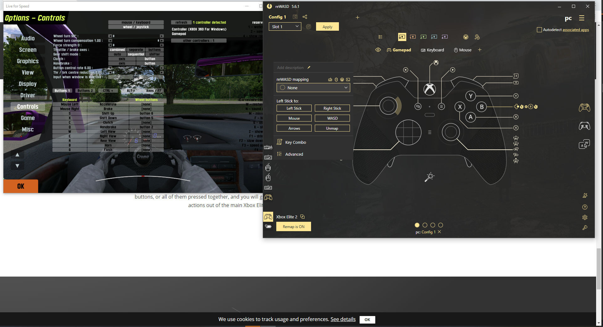

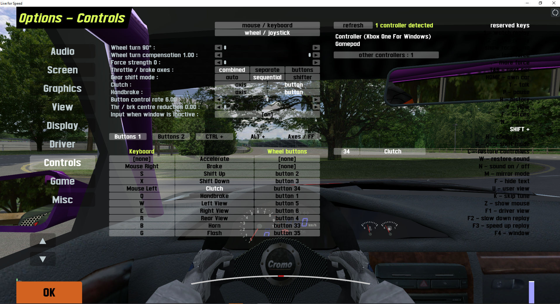

                  i cant believe that i am really that stupid i am trying something els i want that when i shift it taps clutch before shifting
                  so what i did was bind upshift to my gamepad B and bind clutch to --> right pad (no idea what it is called) so both options are now binded to my gamepad right all i did was change the original buttons to gamepad buttons i mean everything works till i try to make a combo from it the buttons i am pressing are white highlighted in this case button 2 and 34.
                  and since its recommended to make a combo from a recording i did but did olso try a lot of different things

                  on the next 2 pictures you see the button i binded it to and the code i used for it what you can not see is that my controller everytime i try to make a combination completely failing to work not just the button but the gamepad stops working on the 3e picture i did remove the combo again and everything works again just the combo does not

                    1. You may set the stick down to paddle or A control. It would work but not as analog — http://recordit.co/LFV08t1vI5.
                    2. About the combo. This is not the GTA 5 game, as I understood. You try to remap your controller to keyboard (S to B, mouse left click to D-pad). In case the game detects the keyboard buttons, use them in a combo as well. Why do you make combo with controls if they are remapped to keyboard?

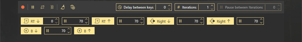

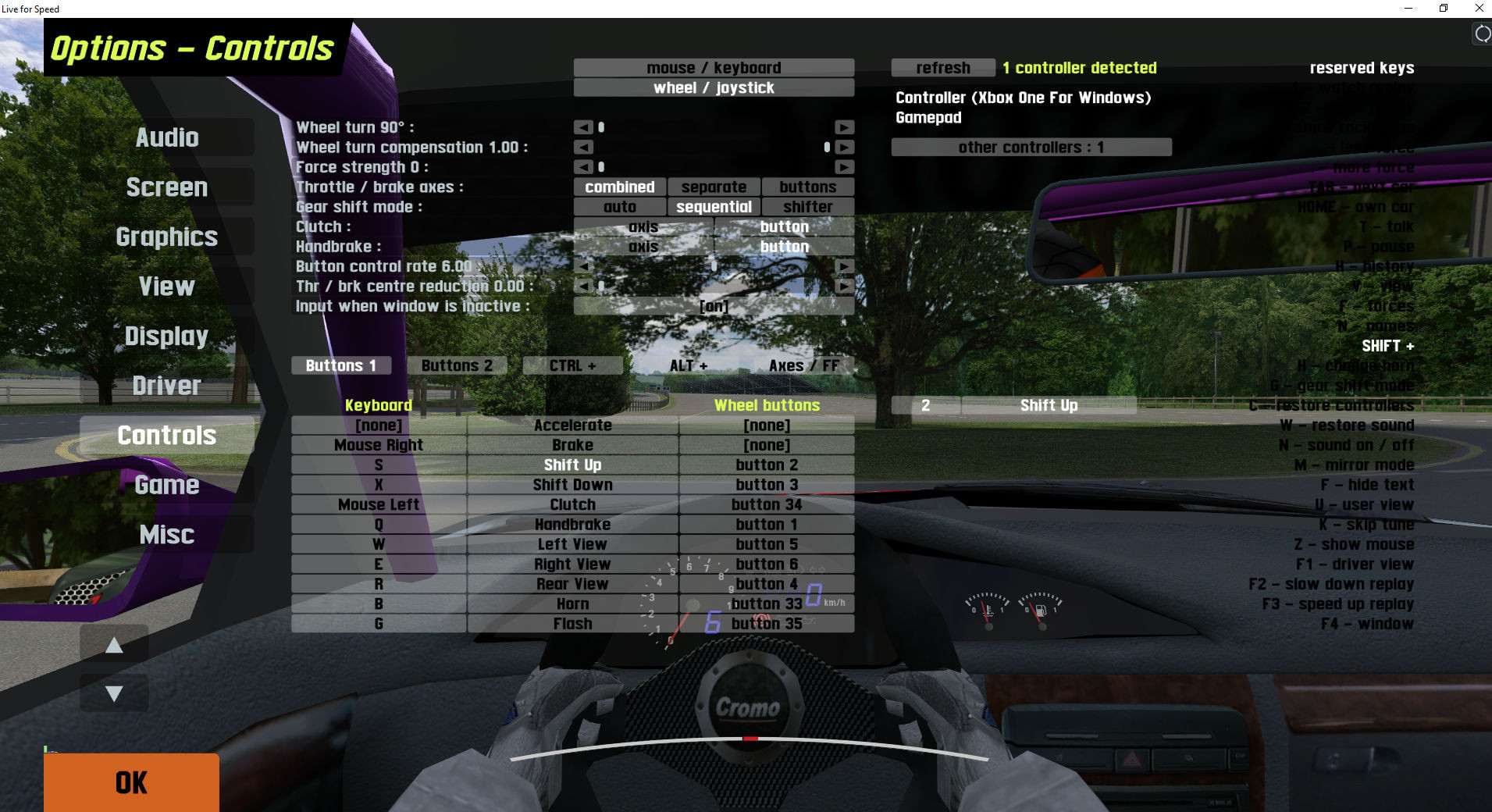

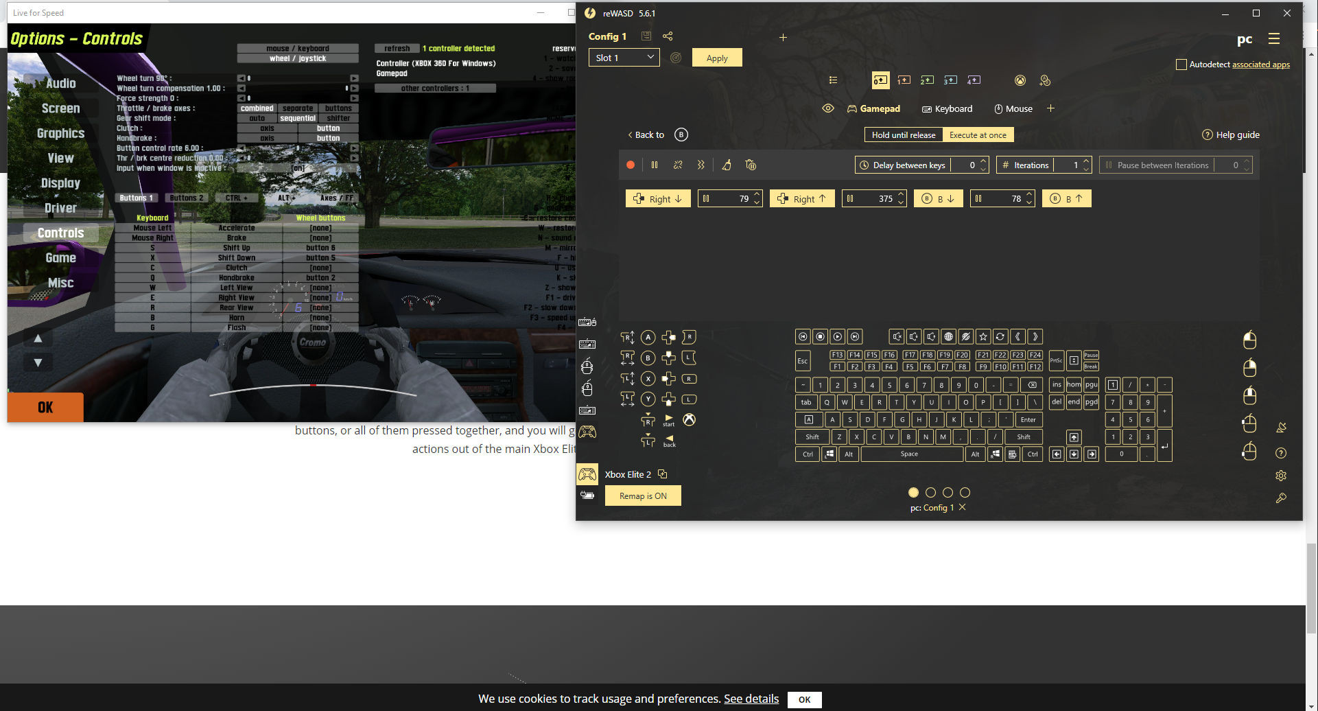

                      2e scenario witch is not gta5 but a different game called life for speed a racing game and i want to make a quick shifter so when i press the shift up button it should release the throttle press the clutch and shift in one go
                      witch means i just hold RT down for acceleration then i push B to shift up witch means RT needs to be released or set to 0 if i understand it right? the right key has to be pressed for the clutch and B for the shifting in one go
                      if this is wrong could i get a picture with the right combo that should work so i can try it and see if it does really work and i am just stupid
                      and what i don't really understand about this software is how it works in the since of buttons do i have to convert keyboard buttons to a gamepad button or do i have to convert a gamepad button to a keyboard button or can i mix it up
                        So if I got it right, you need to:
                        1) release or force [RT] to zero;
                        2) hold [D-Pad Right];
                        3) and push [B] while [D-Pad Right] is held down.
                        Physical analog controls have priority over values set in [Combo], so having [RT=0] at the start is meaningless if you're holding [RT] on your controller at that moment. For the same reason (1) is currently impossible in reWASD.
                        For (2) and (3) to work correctly release of [D-Pad Right] should be at the end, or after the [B] is released.
                        You can also remove all pauses and set [Delay between keys] to 70 for the same effect.
