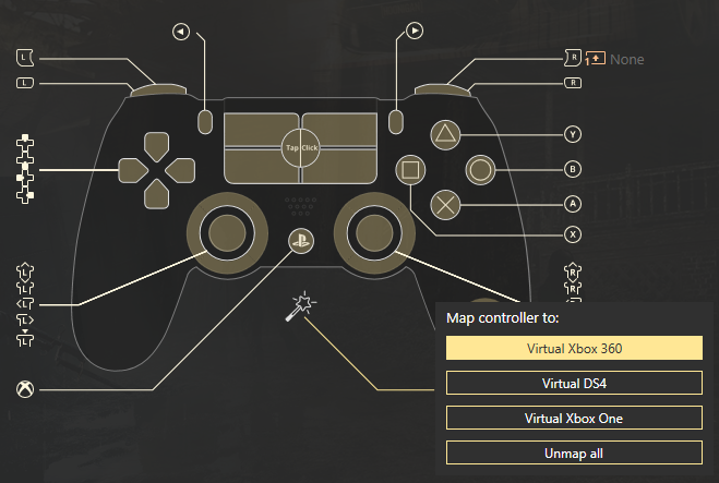

                  The config you've linked insists on creating virtual gamepad, even through it is not needed. Click on the [Magic Wand] and disable any flags there:
                  Click image for larger version  Name:	image_2020-12-22_235608.png Views:	0 Size:	191.6 KB ID:	223057
                  You will need to have an option [Hide physical controller...] as [Preferences > Gamepads] enabled to change this.
                  And don't forget to remove the accidental [Alt] mapping from the zone of left stick.
