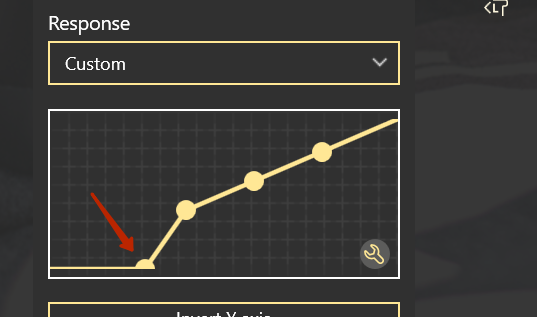

    Virtual controller deflection doesn't influence the stick-to-stick mappings. This setting is used only if the physical device is a mouse or you have some mappings added to the digital button.
    In case of sticks, you set the response curve and it will work for the virtual controller just like it is adjusted and shown. You can set the deadzone too, you just need to put the first point to X axis, just like I have added it here:

      Ah, ok, that's easier!
      To eliminate a game's internal deadzone (assuming no in-game setting), then, I would simply do this?

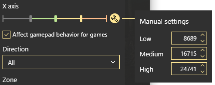

        Yes. You can also get the same result with this (available at [Advanced] settings of a stick):
        Click image for larger version  Name:	image_2020-12-22_231805.png Views:	0 Size:	12.5 KB ID:	223055
        Gray area would be the deadzone. Make sure the [Affect gamepad behavior for games] flag is enabled.
