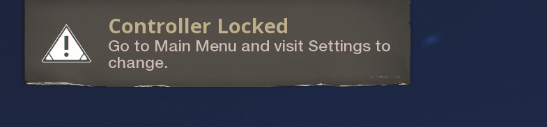

    Hi so my mouse works but when I try to use my keyboard it says controller locked any solutions?
    Could you provide a bit more explanations? Probably some screenshots, where exactly this is told, etc.
ID:	223106 this is what it says when I try to use my keyboard
        Well, it is told what you need to do. Obviously, just switch to the controller input in-game and that's it.
        It depends on what config you use. If you turn your keyboard and mouse to the virtual gamepad, you should use the controller input in-game.
          yea but if I turn it to controller then it says mouse and keyboard lock

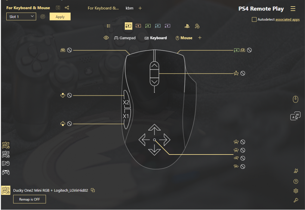

            Hi there,
            Do you try to use reWASD to remap keyboard&mouse to controller? If so, how devices are displayed in the group (here)?
ID:	223112 this is what I have
                Hi there,
                Seems that devices weren't initialized correctly, as it's a virtual device from Logitech, not the physical mouse. Check this YouTube video and re-initialize mouse and keyboard properly, blacklist virtual devices.
                  do you know how to fix the mouse because when I get apply my mouse freezes
                    Once you apply a config with a virtual controller, your mouse and keyboard should be blocked, because otherwise you will get a double input in a game, and it is unplayable. You can switch between two inputs easily. You are using our default PS4 Remote Play config, so you will just need to tap L-Win keyboard key to get your mouse back and tap again to switch to the controller mode.
                    There are a few other methods for this case, you can check them here. Also there is an emergency stop: Ctrl+Alt+Del hotkey on your physical keyboard, it lets you get your devices back and check the settings.
