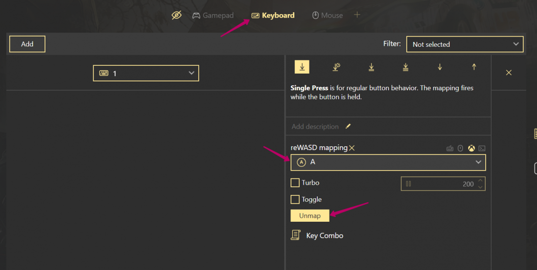

    First of all, if you have a physical keyboard and want it to emulate the controller buttons, you need to add all those mappings to the Keyboard section, like here:
    It is better to add "Unmap" too, it will block the native keyboard input.

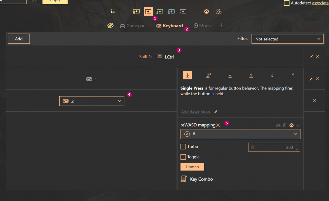

    In your case, if you want Ctrl to be a kind of Modifier, just like it works on the normal keyboard, you do need to use Shift mode. Here are the steps:
    1. Go to Shift 1
    2. Switch to the Keyboard sub-config
    3. Set Ctrl as a modifier
    4. Choose the keyboard key you want to press physically
    5. Add the controller button you want to emulate with Ctrl+2 in reWASD mapping section
    On my screenshot above, Ctrl+2 will work as A button.
    Please let me know if I have understood your case correctly
