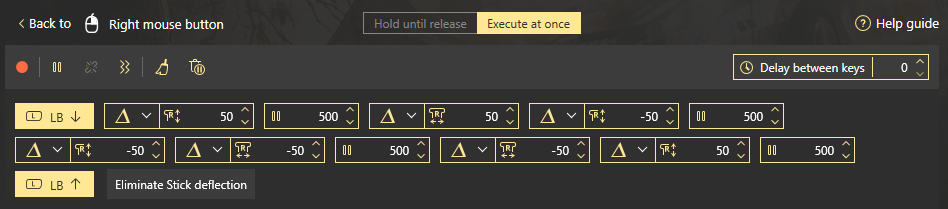

    Im using mkb as a virtual controller, I use the right click as ads, im wondering if while holding ads i can have the right stick move side to side very slightly? trying with macros i have come up short.

      Can I bind the right mouse button to hold L1 whilst drawing a diamond shape with the right stick.

          If you don't mind [L1] being released for 1ms on every "diamond" completion, then this might be a base for your solution:
          Click image for larger version  Name:	image_2021-01-05_074734.png Views:	0 Size:	50.1 KB ID:	223396
          Set [Turbo] flag with 1ms pause for this [Combo]. Deflections are relative. You might need to add more steps and decrease pauses, but this should be enough for an example.

            Yeah I got something similar. is there a way to remove the LB up command? maybe by manually changing the cfg in an editor?
              Nope, there is not way to remove "Up" node, reWASD won't compile such combo.
              Do you want it to be pressed always until you release the mouse button?
              In this case, you may add a big-big pause before LB-up node, and then LB will be released only after the pause is finished or when you release the mouse button. If the pause is quite big, only the second condition will execute.
              If you need to continue moving stick inside this combo, I am afraid the only wait is to make the combo longer.
              Also, I suggest you to check the pause time for Turbo. If you set it to minimal value, does your game still registers the release?
