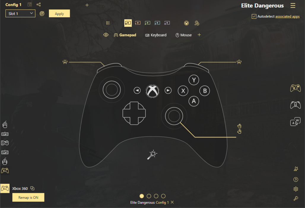

      Basically, I need at least 5 variable/analogue axes. From the controller, Elite only properly reads the thumbsticks as variable, so that's 4. To get 2 more, I'd need to emulate mouse movement on the triggers (or, ideally, on a thumbstick, with one of the thumbstick axes moved to the triggers). This is the simplest attempt at what I need:
Name:	XBOX Control 1.png
        1. According to the screenshot, triggers are remapped to sticks which are virtual controller mappings. But since you've disabled “Hide virtual controller...” option in preferences, there are 2 controllers now in the system, virtual and physical, so the game detects all devices at the same time. Maybe this is a culprit. I would suggest keeping this option enabled.
        2. Try to set the config like this — https://prnt.sc/whegyk. So, you get: triggers works as stick axis, stick Y axis as a mouse, X axis as stick. Don't forget to unmap the right stick.
