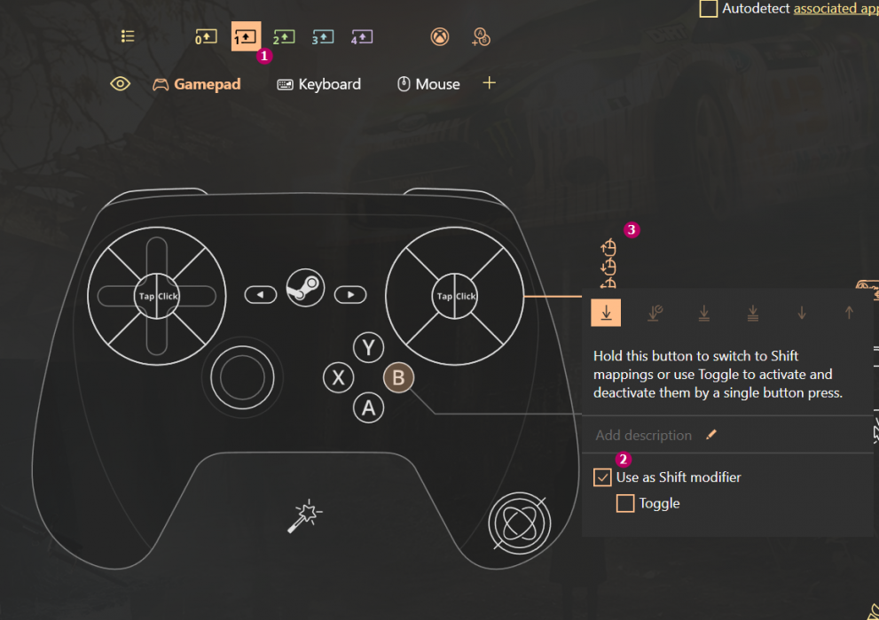

    I'm using a Steam controller and I'm trying to remap it so that when I press the B button it opens my inventory and remaps the the mouse to the joystick rather than the track pad.
    I'm at a total loss though.
    I tried using this help page, but since an update the screenshot here doesn't match the current layout.
    I feel like I've looked through the whole menu scheme to add a mapping option for Shift 1 and I can't seem to find it, any help would be appreciated.
    Shift mode is exactly what you need, but I assume that the pic mislead you a bit.
    In order to use B button as a modifier, you need to go to Shift 1 (or any other) [1] and check "Use as Shift modifier" option [2] there. Then, inside this Shift, you should remap your trackpad to mouse [3]. Hope this screenshot will help:

      Thank you so much, thats exactly what I was looking for.
