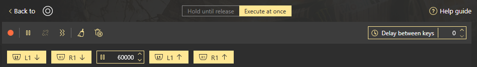

    You can archieve that with a little trick of using specific [Key Combo] with [Rapid fire]. To do that you need to have a combo similar to this one:
    and enable [Toggle] flag for that mapping:
    The key points are:
    - to have delay between keys at zero;
    - to have all "press" nodes before the pause;
    - pause must be longer than the time you're planning to have it held it for. Because once that timer is out - all buttons in that combo will be released for a moment.
