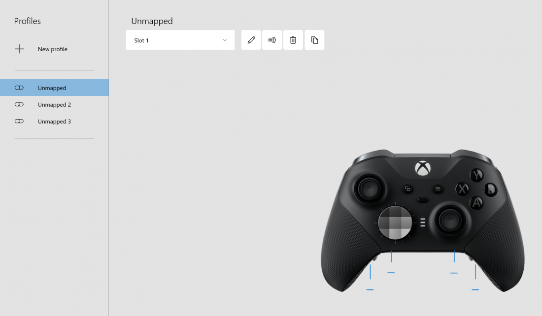

    I did as the tutorial showed and created 3 identical profiles for the paddles unmapped on Xbox Accessories.

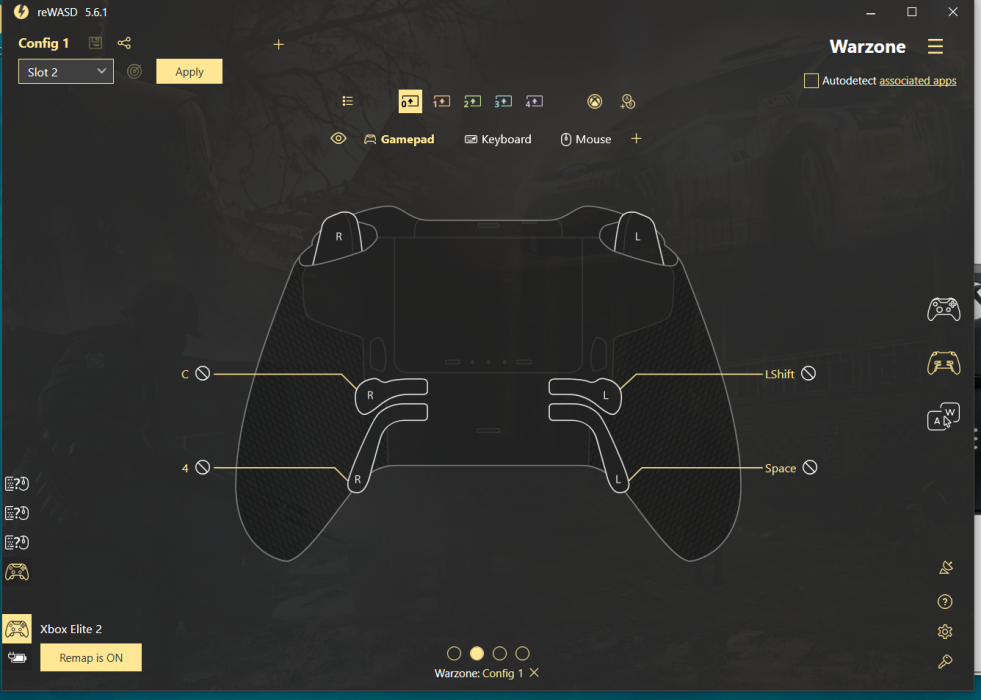

    Then I went over to reWASD and added WARZONE to my game and then selected my ELITE 2 at the bottom. I mapped the 4 paddles to the corresponding key that Warzone has for keyboard. I.E. SPACE BAR is jump so I mapped it on one paddle, "4" is to plate up and I mapped it on another.. and so on and so forth.
    I applied/ saved this on Slot 1 at the top hand corner buut when I go to open Warzone and start up a game, these 4 paddles do not do anything.

    — Do remapped paddles work out of the game? Like, if you open the notepad you will see the remapped keyboard buttons by pressing paddles.
    — Xbox Elite 2 has 0,1,2,3 profiles, reWASD has 1,2,3,4 responsively. So zero profile on the controller equals to #1 slot in reWASD. Make sure that the button on a controller has a 0 position to apply the config to slot 1.
    — Please, unmap paddles in reWASD too (screenshot) to keep only remapped input. Try in the game.
      1) Yes, paddles work as mapped in Notepad
      2) I have it set as SLOT 2 on reWASD but on Profile 1 on the Elite 2.
      3) I hit UNMAP like your screenshot and tried it in game and still not working in game.

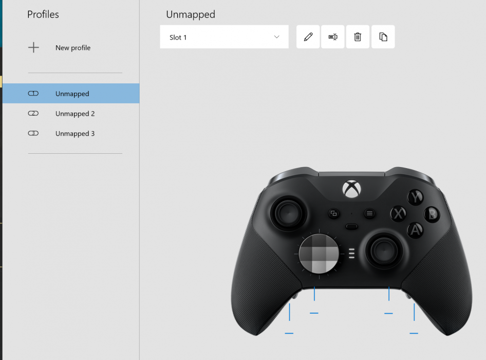

      see screenshots below for my current settings.
ID:	223655Click image for larger version

        Could be that you're playing controller type based matchmaking. In that case game would ignore any non-gamepad inputs (and you are mapping your paddles to keyboard keys there).
