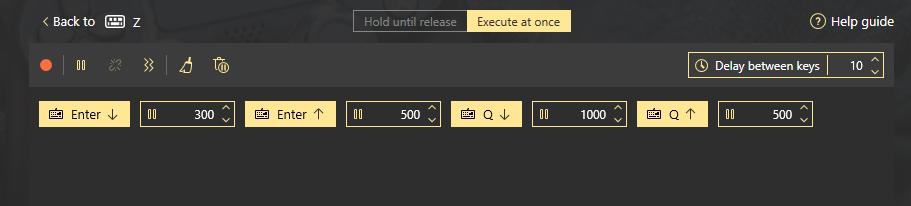

              i want hold L1 or double R1 in games , how to set it in VK , thanks
                If you need to press and hold L1, use the combo with "Hold until release" mode, like this (screenshot). In this case, the L1 will be triggered as long you pressed the remapped button.
                As for R1, do you need to press the button and R1 released press\release twice, don't you? In this case add R1 in combo two times with small delay between (screenshot). As the results, the R1 triggers twice when the remapped button is pressed.

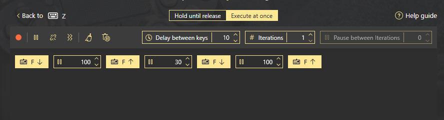

                  when i press twice a single press 'f' it action in games but with 'z' combo is not
                    You were saying, that you configure the remote play config to emulate the controller playing on the console via remote play. This mapping will not work as the game requires controller inputs, you have keyboard mappings instead. You need to replace combo with controller buttons.
                      You can guide more detail ? what can i config controller buttons?
                        As we have explained this already, this article is for you: link.
