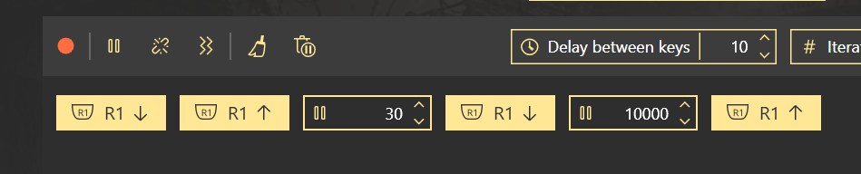

            1. Create a combo In Execute at once mode that consists of one press, pause and the a press with long-long pause, like I have here:

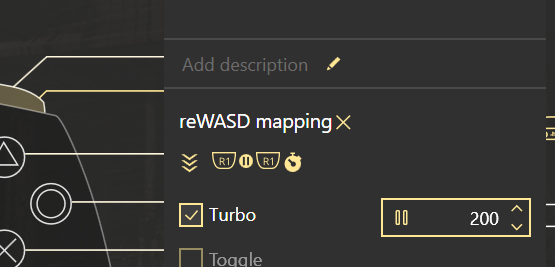

            2. Get back to the Main window and set this combo to Turbo:
            Once you press and hold this button, it will start emulating a combo: press and release once, then press and will hold the second R1 for 10 seconds. However, with Turbo, the combo will be stopped once you release the physical button, so this way we will emulate the "hold until release" behavior. Would be grateful if you try this in your game. Also, you may need to set a bigger Delay between keys if the game doesn't detect the input at once.

                  Sorry to bumb a months old post, but this seems to fail for me 1/3 times. Any suggestions on what I can change?
                    Try setting [Delay between keys] to 20 or a higher value.
                    A pause of 17ms or more is required for a game running at stable 60FPS to "notice" a button being pressed.
                      So far huge improvement thank you!
