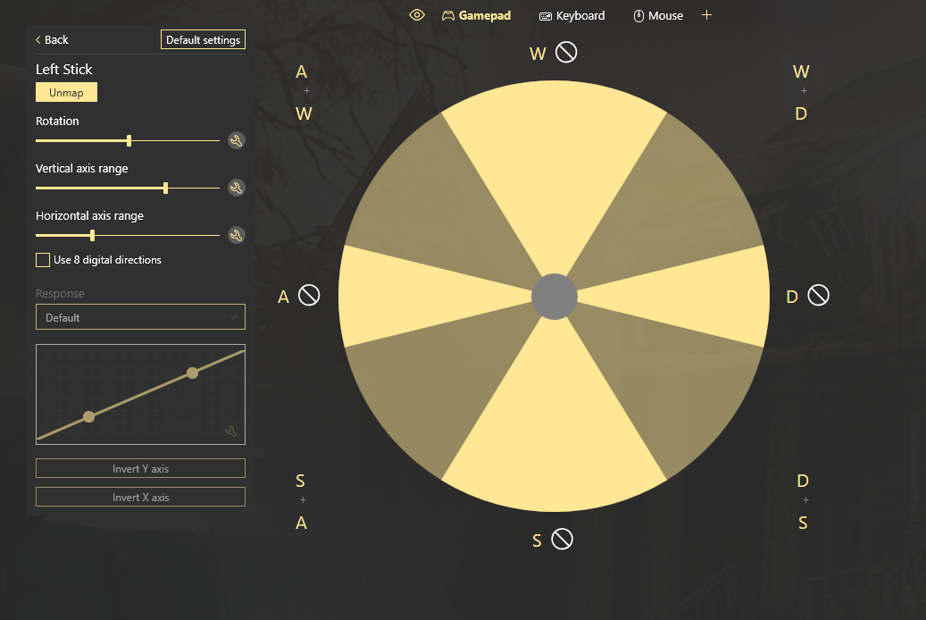

    Attached are my settings for the analogue stick, so the area where the stick is supposed to output the W+A command is quite large, yet, as I said, every now and then it isn't even being registered.

    2. Try to get back to the default Vertical and Horizontal axes range. The sticks on Sony controllers are not precise actually. It may be a chance that the area is actually not that big. Also, you may try to set it even smaller than the default values.
    Also, please send me your config to check if something else interferes. Your configs are stored here: C:\Users\Public\Documents\reWASD\Profiles I need the correspondent *.rewasd file.

      I am running the latest version of reWASD. I'll set the axes to defaults and reduce it a little to see if that sorts the issue.

        Do not see anything wrong in the config, will try it with the PS Nav a bit later. Hope changing axes range may help here too.
