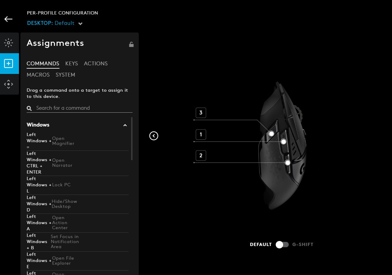

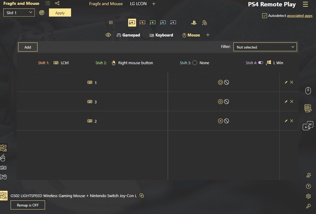

                so i tried this - and put numerical values in the logitech app. and then remapped these numericals values to remote ps4 virtual mappings and in game it still doesnt work
Name:	rewasd screen.jpg
ID:	224506Click image for larger version
                    But on a screenshot I can see that you have not applied the config. Apply it and test it on a https://gamepad-tester.com
