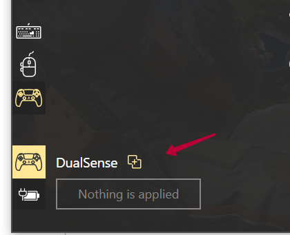

    Most likely you haven't selected your Xbox One Controller as an active device at left bottom corner.
      Hello, I have the same problem as above, I do not understand what Shion means to have a controller as an active device at left bottom corner, do you mean to have it as "Remap is ON"? in that case it is on, but still the controller doesn't work properly
      I find it works intermittently, and this is quite frustrating, what does the above message mean, and how can we resolve it?
        Shion hints at this corner:
        Click image for larger version  Name:	n2YZgNlhb8kkNA?d=1.png Views:	0 Size:	84.0 KB ID:	226435
        The device you are remapping should be selected here as an active one.
        This message appears if you are creating a virtual controller on some device and have other physical controller connected.

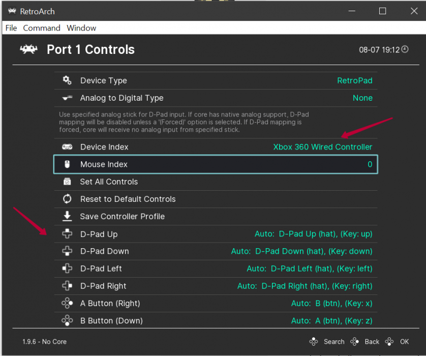

                            Hm, at first, I thought that the gamepad is not detected by the app, however, yep, I see now. So it is recognized but is not working? But it does work with a physical one? Pretty strange, moreover, I have just checked RetroArch, and I have no issues with it at all
                            Could you please re-check the settings the controller has in RetroArch, here are they. Maybe you have different mappings inside the app itself?
                            Click image for larger version  Name:	1295177cb7.png Views:	0 Size:	307.9 KB ID:	226455
                              reWASDer thanks for the help, I confirm my settings are right, in fact if you note on the video(s), intermittently reWASD mapping works, and when it works, it is recognised in RetroArch and all the inputs are rightly received, even all the complex ones.
