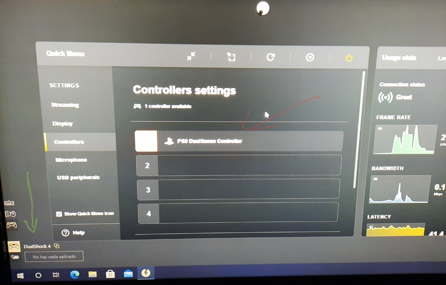

      Well,actually Shadow detects properly the Dualsense as you can check in the attached image,but reWASD doesn't detect it as Dualsense,but as DS4.

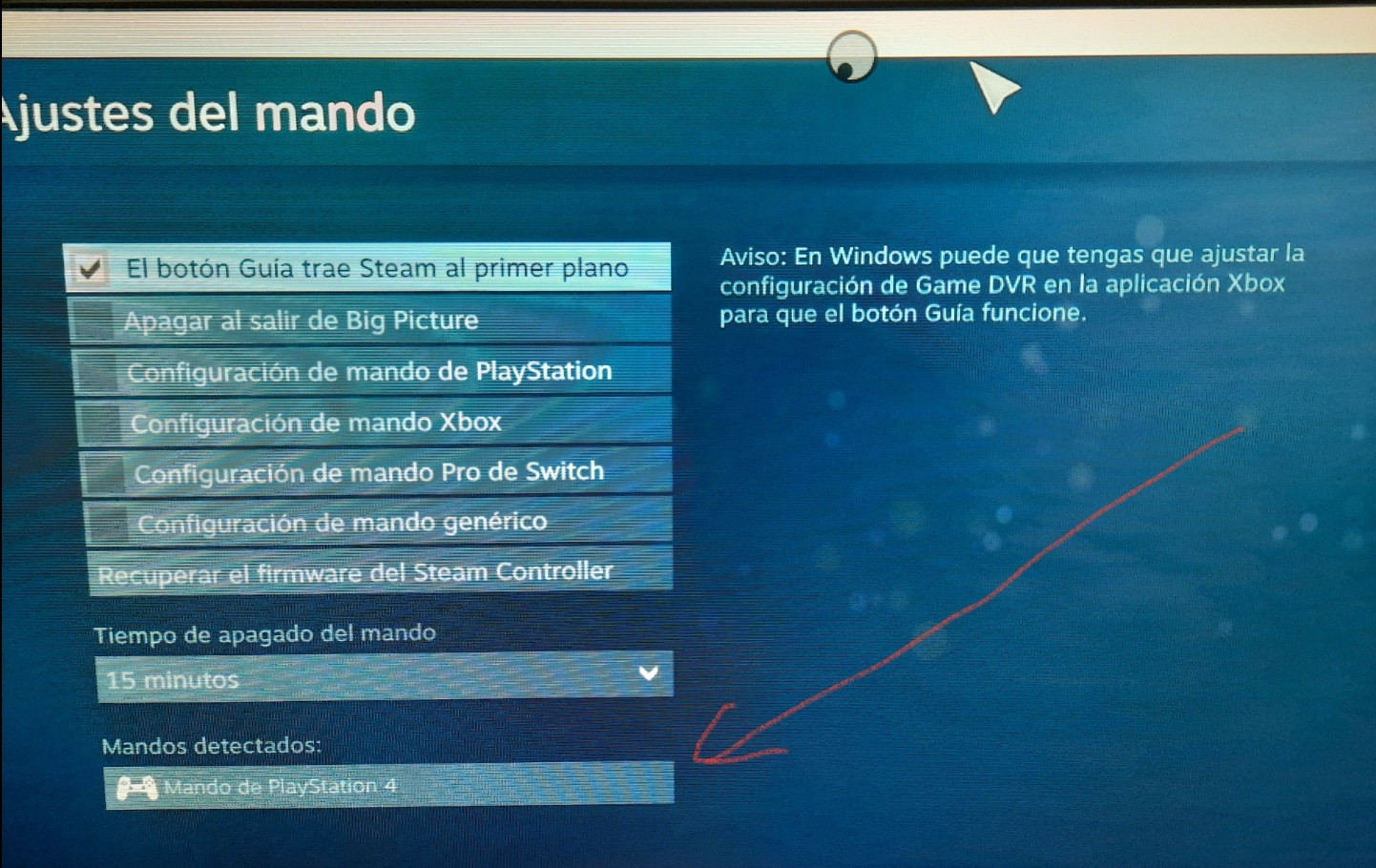

          Steam: Dualsense is detected as DS4 but touchpad doesn't work

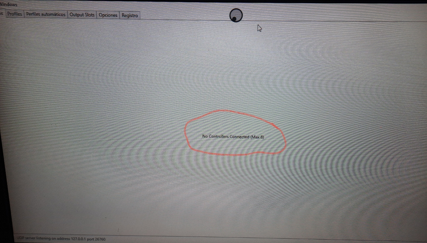

          DS4Windows: It detects nothing
