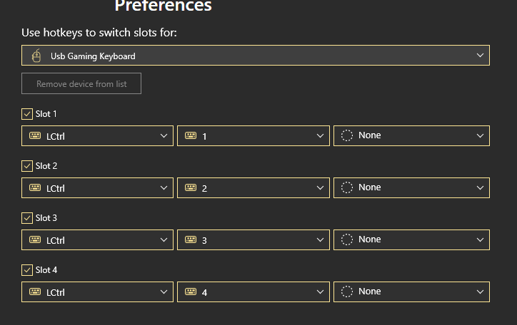

    How many buttons you've set to a shortcut to change slots (a screenshot of [Preferences > Slots] would be nice)?

Name:	Sem título.png

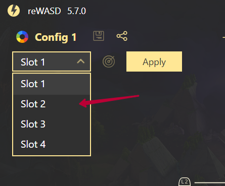

          When I try to apply config 2 to slot 2 he set to slot 1.
          Note: yes I know that you have to select the slot first to choose the configuration.
            Just a small clarification: you need to choose the Slot near Apply button in this case. Any chance that you have changed the slots at the bottom?

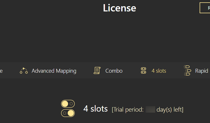

            Also, please check the License tab (an icon with a key at the bottom right). Open it, go to Slots tab and check whether you have active trial days in the title:
              That was embarrassing , when I hold CTRL and then press 1 does not change the slot but if I press the two buttons together it works.
              Thanks... problem solved
