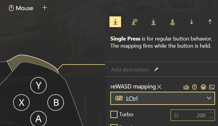

      I think you could try a bit another setup:
      Try to map the key to R1, while R1 should not be unmapped, like here:
      In the game settings, ensure that you have chosen the controller input (it may be locked in Warzone).
      If there is only one thing you need to add, ensure that you do not use the virtual controller — I think the physical one is better in your case.
