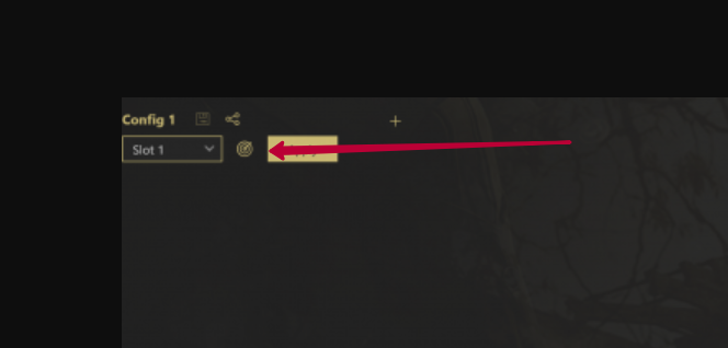

        You still need to activate the Autodetect with this icon:
        Please check more info in our help guide.
