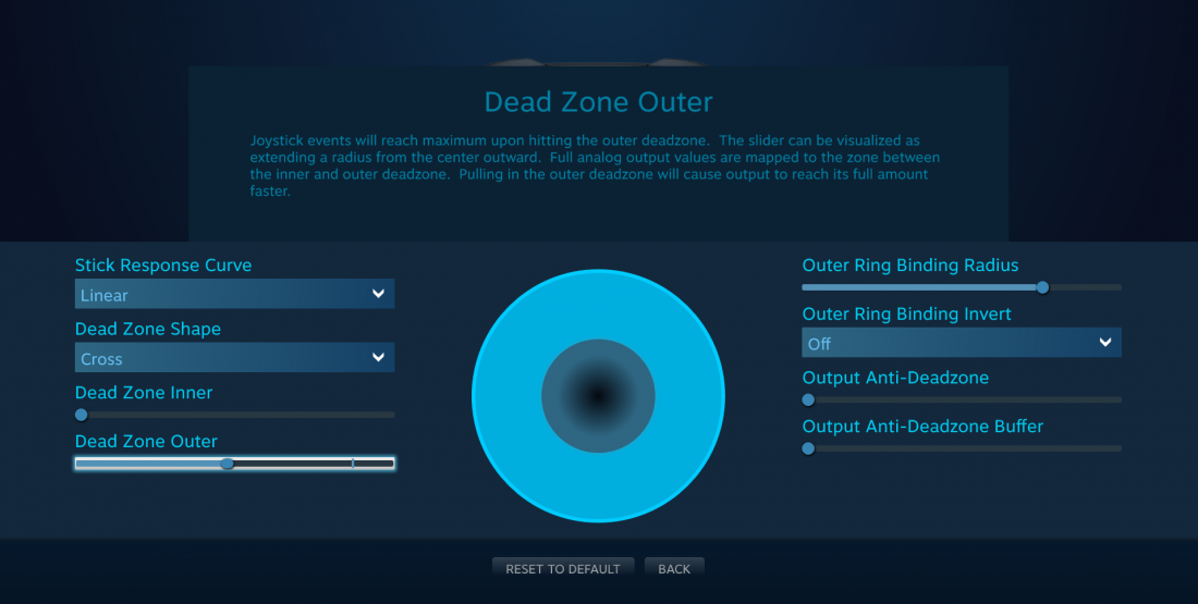

      While this helps, this isn't quite what I'm looking for, something like in Steam where you can set a maximum outer deadzone. Though maybe my pro controller drifting is just too strong sometimes, sigh. :/ Click image for larger version

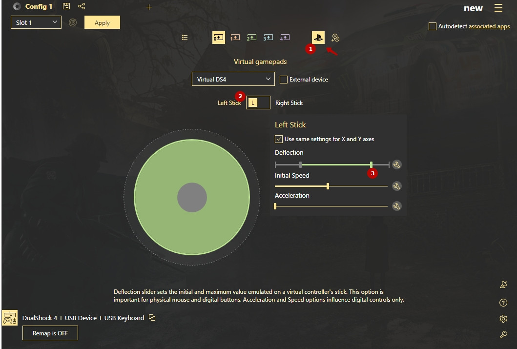

        Hello. Go to virtual controller settings (1), select the desired stick (2), adjust the right slider of the dead zone as you need (3)
        Click image for larger version  Name:	09d813ac60.jpg Views:	27 Size:	111.4 KB ID:	225329
          Not sure why the curve doesn't work in your case. Could you please show it to me? It should be pretty much the same that the Steam's setting does.
