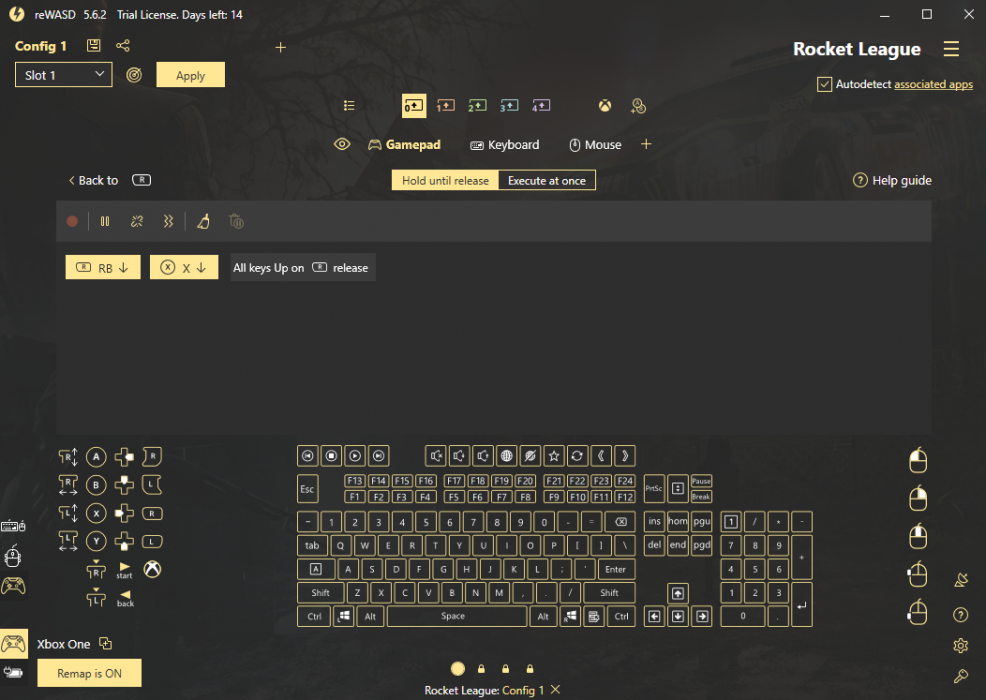

    I'm trying to figure out if ReWASD will do what I need it to before I purchase it. While R1 is being held down I want it to act as if R1 and Square are both being held down (but there is a slight problem).
    I have the trial and I setup a Key Combo for R1 that is "Hold Until Release" that holds down R1 and Square. The problem is that if:
    Start holding R1 (works perfectly, both R1 and Square are active)
    Start holding Square (works perfectly, both R1 and Square are active)
    Release R1 (R1 and Square are both released)
    Now Square is still being held down physically, however the game doesn't recognize Square at all (presumably because of the release that was issued when I released R1).
    The problem does not happen in the other direction.
    Start holding R1
    Release Square (things are working perfectly still, R1 and Square are both active even though Square was physically released)

      Here is my current window for R1 key combo:

        Also, I'm sure it's a lot easier said than done, but theoretically if you could check whether a button is physically being pushed or not, you should be able to decide whether a key should be released or not. What I mean by that is that when R1 is released and this key combo is going to release R1 and X, a few lines of code could quickly check if X is being pushed elsewhere (ideally checking both the physical key and and other key combos currently active).
        I have a decent amount of experience with Autohotkey so I've written that kind of thing in scripts before. Although I have no idea how feasible or difficult that would be to add to ReWASD.

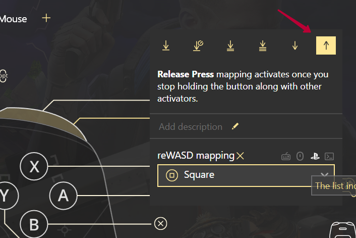

          Sorry, it should look better with a screenshot.
          I am about this activator — the action that is emulated when you release a physical button:
            I gave it a try, but the behaviour is still the same (once R1 is released, the game ignores the fact that I am still holding Square).
