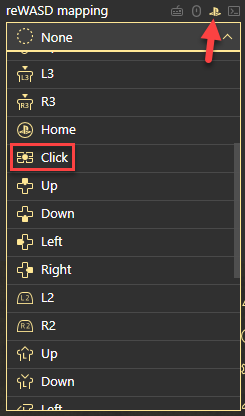

    It is right here:
    Leave a comment:

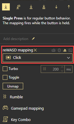

    Touchpad swipe and taps are not clicks. Try mapping to this:
    Click image for larger version  Name:	2021-05-16_2-00-00.png Views:	0 Size:	16.5 KB ID:	225538

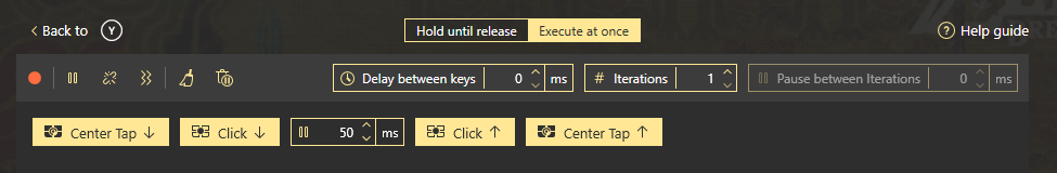

    You can also try to make a [Combo] with tap+click like this:
    Click image for larger version  Name:	2021-05-16_2-06-18.png Views:	0 Size:	57.6 KB ID:	225539
