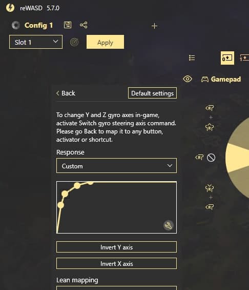

    Hello!The only way to change the sensitivity of the gyroscope is to change the response curve in Gyroscopes Advanced Settings as you described. Based on what you have written I can recommend you this curve setting. Unfortunately it is not possible to increase the sensitivity significantly, but we will note your suggestion.

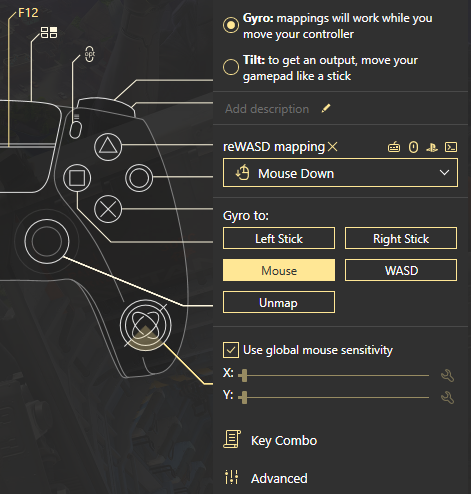

        If you select the mouse, then you will have access to the sliders for adjusting the sensitivity (as in the screenshot), but the response curve is much more accurate to adjust.

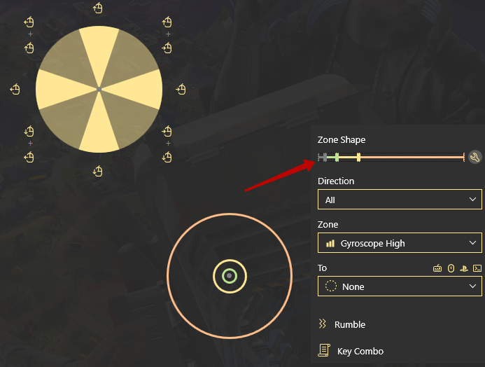

        If you want to remove deadzone, then this slider is available in advanced settings.

          There's still a deadzone even when zone shape is adjusted to 0 ingame when gyro is set as a joystick. Atleast it feels like it.

            Set Response of the gyroscope using the curve. The horizontal axis of a curve stands for how fast you move the controller. The vertical axis stands for the mappings. With a stick mapped to gyro, the min point is a stick’s deadzone, and the max point is the max deflection.
            In your case, try raising the first point on the curve a little. In your case, try raising the first point on the curve a little to override the game deadzone.

                This is about the Response curve. You can change the position of 4 dots, each of which has two parameters: X and Y, for horizontal and vertical axes. X value (horizontal) is about how fast you are turning your gamepad while using the gyro (I assume you have chosen Gyro mode, right?). The Y options stand for the final output — the deflection of the stick, the value that shows how far the stick is deflected.
                You need to override the in-game stick deadzone. It means that when you turning the gamepad slowly (X values are low), you should get a big stick deflection (Y value) at once. This is why we recommend adjust the curve this way — make the first points higher.

                    Yes, [Response] curve is answer to almost anything. No other way around it. The first point (1) of the curve above zero is what would set the sensitivity for your gyro (closer to the right side - bigger must be the movement to get registered). And the last point at the top (2) would set the maximum turning speed required for maximum stick deflection.
