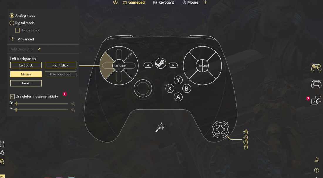

    But today I was using my steam controller with rewasd, wanted to do some stuff with the trackpads and turns out the mouse using the trackpads has that same feeling too! so I'm here wondering, maybe reWASD gyro is perfectly fine, and what's happening is that the virtual mouse that uses rewasd has some kind of smoothing going on, It definitely feels like there's some input lag and I feel like that's mostly the reason the gyro doesn't feel quite there, I've set up some aimlab testing using steam vs rewasd with my steam controller and i definitely underperform with rewasd

      As for the trackpads, I think you miss the trackball option that is available in Steam and that is why the movement is a bit different. We will add this one in the upcoming releases.

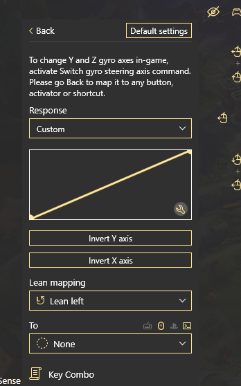

        Thank you for responses, sadly I've tried all kind of custom curves and none are quite there, I've somewhat settled with this one as this one got recommended by another rewasd user:

        you can still feel the smoothing sadly, I was paranoid about it and I ran a few tests in aimlab and I'm sure rewasd is the odd one out,

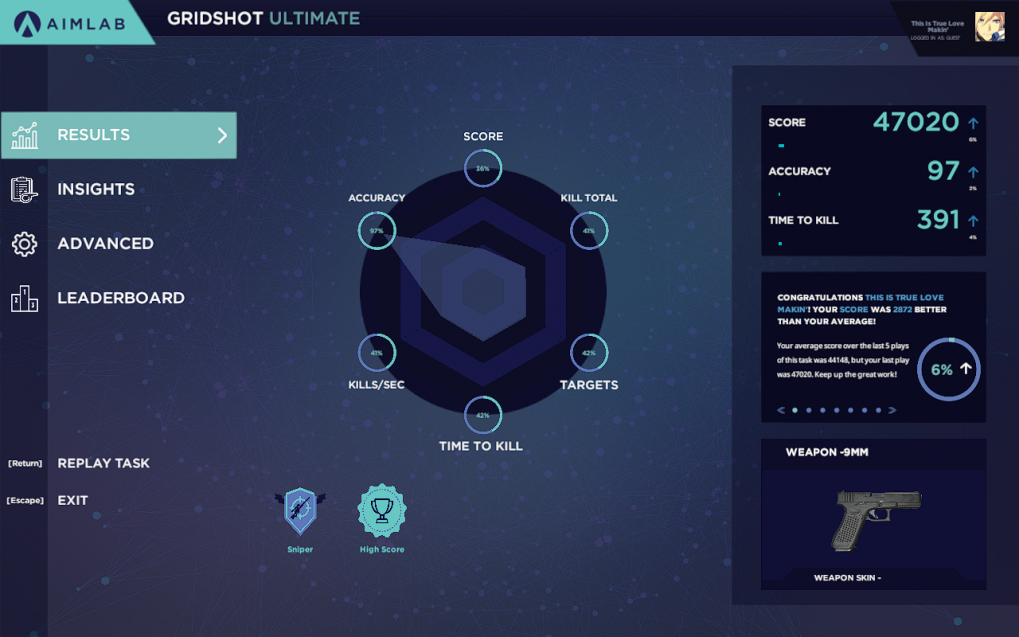

        here are my results with similar configs (similar feeling in mouse sensitivity, no accel)
        I did a few runs and picked the best one, all of these were run with a dual sense
        Steam gyro: (all rounds were between 40k and 47k, did around 6 rounds and picked the best one):

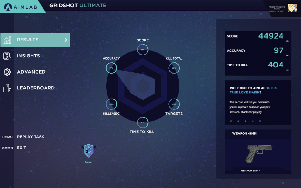

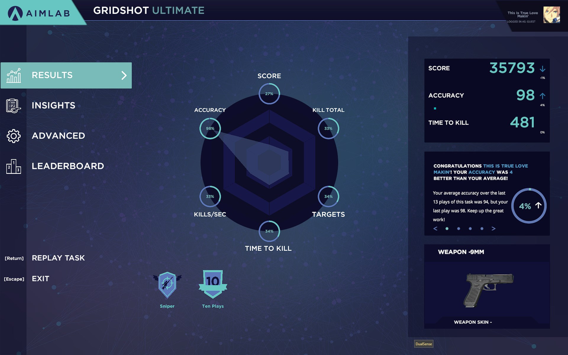

        reWASD gyro (around 15 rounds, picked the best one too, all others were around the 30k-32k):

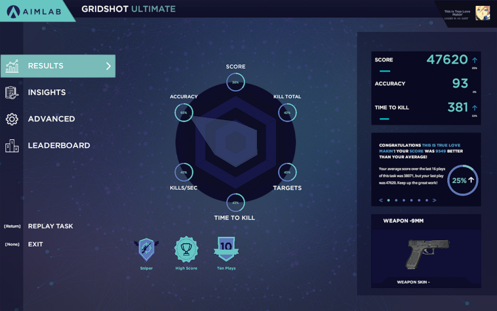

        Bonus: one round with ds4windows out of the box:

          Frankly speaking, you have pretty interesting Response curve. Usually, we recommend using a "sharper" one. But of course tastes differ.

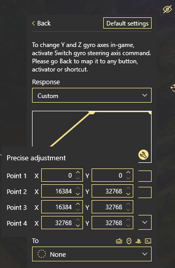

            you're definitely right than a more aggressive curve would be good, at the end and after trial and error I'm more comfortable with something closer to this

            It definitely feels like I'm hitting closer to 40k with this one so it's definitely an improvement! the dragging is still present, but it's definitely an improvement, it also feels more snappy, I feel like more aggressive curves also don't feel that good, so this one's the sweetspot for me
