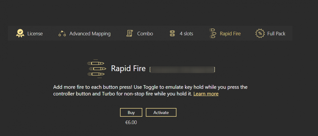

        And one more thing to check: Toggle Shift requires the additional feature — Rapid Fire. Please go to the License (an icon with a key at the bottom right) and check whether it is active (have trial days in the title or already purchased).

                  Regarding the license: Paid one could include the advanced features or not. I am referring to this particular one:

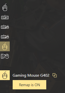

                  If you can't "hook" this key in the list anymore, please re-check which device you are using. Logitech creates two virtual devices (which are also shown in our GUI), but the correct one for your case is a physical as far as we know (though, we do not have this particular model, so it may be a chance that you should re-check all of them).

                      It shows as a single device, it even auto tagged itself as gaming mouse.
